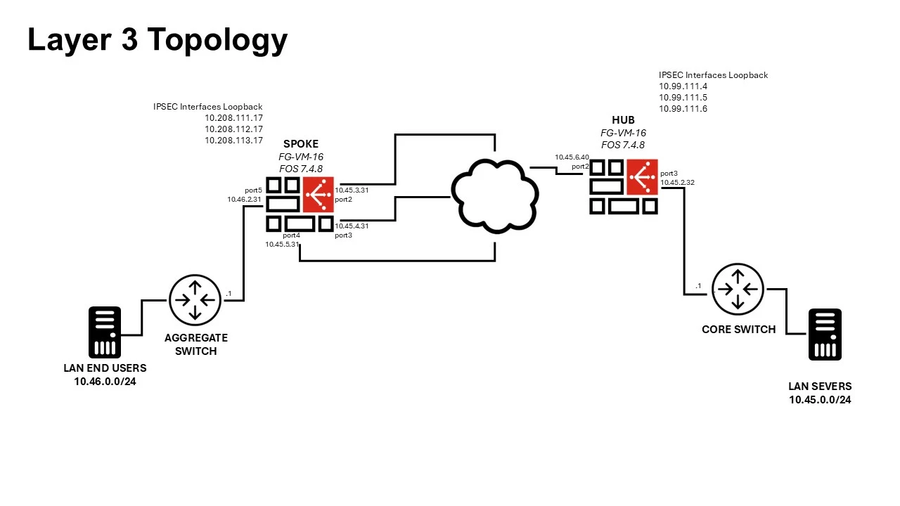

FortiGate's IPsec Aggregate interface provides per-packet load balancing and redundancy by combining multiple IPsec tunnels into a single logical interface. You can configure it with algorithms like Round-robin, L3 (based on IP addresses), L4 (based on TCP/UDP ports), or Redundant (using the first available tunnel) to distribute traffic and increase capacity or provide failover for site-to-site VPNs. The topology has one Spoke with three underlays and one HUB with one underlay. For the creation of IPsec tunnel (S2S), each tunnel has a loopback interface. The configuration shows the creation of one IPsec Aggregate interface with the algorithm Round-robin, for the three IPsec tunnels and the setup of SDWAN rule for this purpose.
Step 1: Configure Loopback Interfaces:
Spoke:
config system interface
    edit "loopback1"
        set vdom "root"
        set ip 10.208.111.17 255.255.255.255
        set allowaccess ping
        set type loopback
    edit "loopback2"
        set vdom "root"
        set ip 10.208.112.17 255.255.255.255
        set type loopback
    edit "loopback3"
        set vdom "root"
        set ip 10.208.113.17 255.255.255.255
        set type loopback

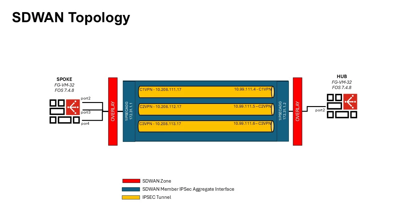

Step 3: Configure IPsec Interface Aggregate:
Spoke:
config system ipsec-aggregate
    edit "1IPSECAGG"
        set member "C1VPN" "C2VPN" "C3VPN"
        set algorithm round-robin
    edit "1IPSECAGG"
        set vdom "root"
        set ip 172.31.1.1 255.255.255.255
        set type tunnel
        set remote-ip 172.31.1.2 255.255.255.255
        set monitor-bandwidth enable
        set role wan
Hub:
    edit "1IPSECAGG"
    edit "1IPSECAGG"
        set vdom "root"
        set ip 172.31.1.2 255.255.255.255
        set type tunnel
        set remote-ip 172.31.1.1 255.255.255.255
        set role wan

Step 5: Configure SD-WAN.
Spoke:
config system sdwan
    set status enable
        config zone
            edit "OVERLAY"
        config members
                set interface "1IPSECAGG"
                set zone "OVERLAY"
        config health-check
            edit "SLA_LOOPBACK"
                set server "10.99.111.100"
                set interval 1000
                set failtime 3
                set members 1
                    config sla
                            set link-cost-factor latency
                            set latency-threshold 150
            config service
                    set name "ALL_TRAFFIC"
                    set mode sla
                    set dst "all"
                    set src "all"
                        config sla
                            edit " SLA_LOOPBACK "
                                set id 1
                    set priority-members 1
config router static
    edit 5
        set dst 10.99.111.100 255.255.255.255
        set distance 1
        set sdwan-zone "OVERLAY"
        set comment "SLA Health Check"

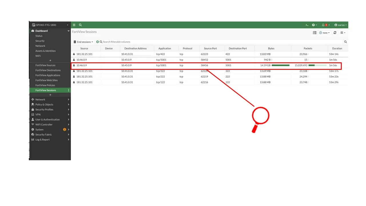

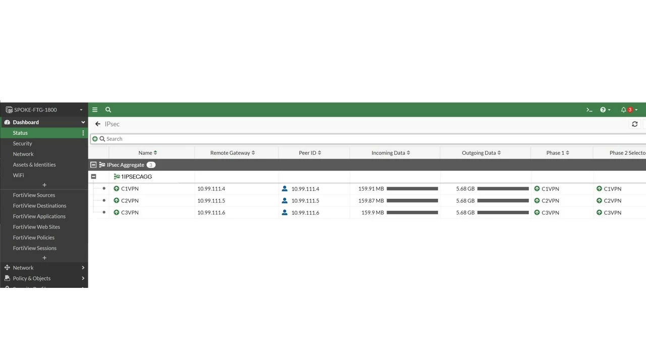

Monitoring of per-packet distribution:
Figure 1: One TCP session is balanced by 3 IPsec tunnels (site to site).
Figure 2: One TCP session from host 10.46.0.9 to server 10.45.0.9.
