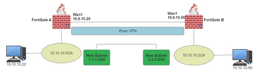

In this example, computer 10.10.10.22 wants to communicate with computer 10.10.10.56 on the other side of the tunnel.
To achieve communication, it is necessary to create a new subnet on both sides and translate the traffic using a VIP.
  • FortiGate A internal Subnet 10.10.10.0/24 is going to be mapped to 1.1.1.0/24.
  • FortiGate B internal Subnet 10.10.10.0/24 is going to be mapped to 2.2.2.0/24.
Note that 1.1.1.0/24 and 2.2.2.0/24 subnets are used as examples. Use a private IP range for configuration.

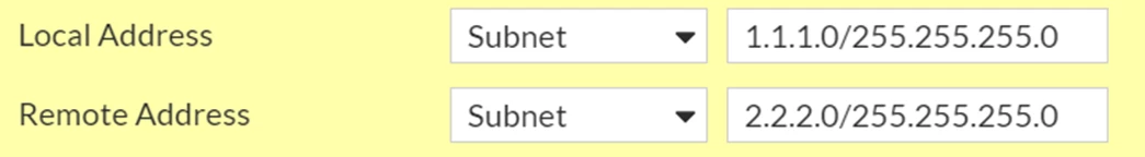

  1. Change the local and remote subnet on the IPsec Phase 2 Selectors for the new subnet.
It is also either possible to choose the Named Address previously created or Select Subnet and add manually.
If there are multiple subnets to route on the tunnel, it is also possible to use 0.0.0.0/0 as the local and remote subnets.

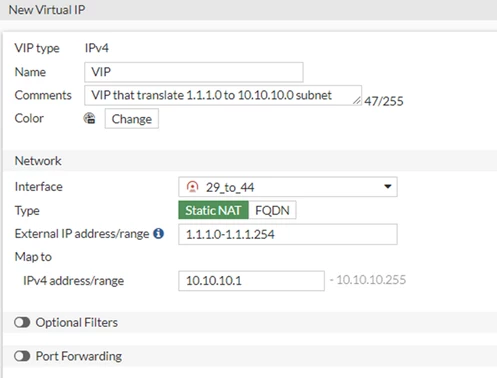

  1. Create the VIP. Go to Policy & Object -> Virtual Ips and select 'Create New'.
The purpose of this VIP is to translate traffic coming from 1.1.1.0 to the internal subnet 10.10.10.0. For example, inbound traffic with destination 1.1.1.46 will be routed to 10.10.10.46
Make sure to select the IPsec tunnel in the Interface Option:
Otherwise, this can cause routing issues from Lan to Wan.

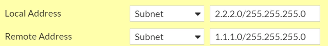

Configuration on FortiGate B.
Go to Policy & Objects -> Addresses and select 'Create New'.
  1. Create the local subnet address:
  1. Create the new local Subnet for IPsec:
  1. Create the new Remote subnet Address:
If there are multiple subnets to route on the tunnel,l it is also possible touse 0.0.0.0/0 as the local and remote subnets.

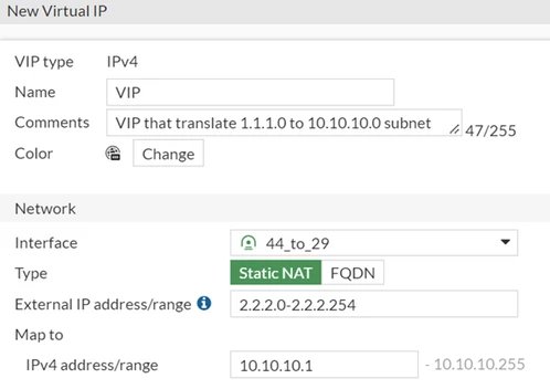

Make sure to select the IPsec tunnel in the Interface Option.

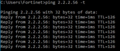

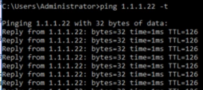

Test the behavior.
Computer 10.10.10.22 on FortiGate A side wants to communicate with Computer 10.10.10.56 on FortiGate B side. Computer 10.10.10.22 will need to send traffic to the new assigned subnet by replacing 10.10.10.56 by 2.2.2.56.
The same goes for Computer 10.10.10.56 which wants to communicate with Computer 10.10.10.22. Computer 10.10.10.56 will need to send traffic to the new assigned subnet replacing 10.10.10.56 by 1.1.1.22.

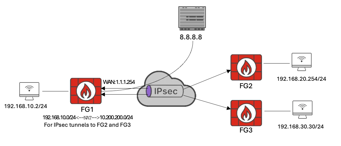

Scenario 2: Subnet to subnet NAT for two or more IPSec tunnels
It is a common requirement to have primary and backup tunnels to a location. When a subnet-to-subnet NAT is needed, it is required to be applied for both IPsec tunnels.
The solution described below is scalable for one or more IPsec tunnels as needed.
Requirements:
1. FG1 LAN (192.168.10.0/24) should have internet access via a SNAT (PAT in this case) to the WAN interface IP address, 1.1.1.254.
2. Traffic initiated from the FG1 LAN towards either of the IPsec tunnels (to FG2 or FG3) should undergo a subnet-to-subnet SNAT (source NAT) from 192.168.10.0/24 to 10.200.200.0/24 such that when traffic reacheds FG2 or FG3, the source network is observed to be 10.200.200.0/24.
3. Traffic initiated from FG2 or FG3 LAN networks (192.168.20.0/24 and 192.168.30.0/24 respectively) towards 10.200.200.0/24 should reach FG1 and undergo DNAT (Destination NAT) to the FG1 LAN network 192.168.10.0/24.
Configuration:
IPsec settings, policy and routes for tunneled networks:
  • The IPsec traffic selectors can either be wildcard (0.0.0.0/0.0.0.0 to 0.0.0.0/0.0.0.0) or, should have the source (on FG1) and destination (on FG2/FG3) as 10.200.200.0/24.
  • FG2 and FG3 will have routes pointing to the tunnel towards FG1 for 10.200.200.0/24 and policies referencing this network.

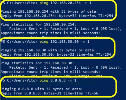

  1. Outbound traffic verification:
Initiate traffic towards the internet (8.8.8.8, example), FG2 LAN and FG3 LAN and observe the NAT translations:
Ping:
