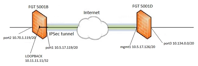

Diagram:
Configuration:
FortiGate 5001B configuration: IPsec terminate on Loopback interface:

FortiGate 5001D configuration.
config system interface
    edit "mgmt1"
        set vdom "root"
        set ip 10.5.17.126 255.255.240.0
        set allowaccess ping https ssh http telnet
        set type physical
        set snmp-index 10
    edit "phase1"
        set vdom "root"
        set type tunnel
        set snmp-index 22
        set interface "mgmt1"
    edit "phase1"
        set proposal 3des-sha1 aes128-sha1
        set remote-gw 10.11.11.11
        set psksecret ENC dmFyL8GXi28fONH6tP4+
        set auto-negotiate disable
    edit "phase2"
        set phase1name "phase1"
        set src-subnet 10.134.0.0 255.255.240.0
        set dst-subnet 10.70.0.0 255.255.240.0
config firewall address
    edit "remote70"
        set subnet 10.70.0.0 255.255.240.0
    edit "local134"
        set subnet 10.134.0.0 255.255.240.0
config firewall policy
        set uuid f19f4ada-a2d2-51e6-86c7-b655bc7acc90
        set srcintf "phase1"
        set dstintf "port3"
        set srcaddr "remote70"
        set dstaddr "local134"
        set service "ALL"
        set uuid 2ad09f98-a2d3-51e6-194e-7de97d90d457
        set srcintf "port3"
        set dstintf "phase1"
        set srcaddr "local134"
        set dstaddr "remote70"
        set service "ALL"
config router static
        set dst 10.70.0.0 255.255.240.0
        set device "phase1"
    edit 4
        set dst 10.11.11.11 255.255.255.255
        set gateway 10.5.17.119
        set device "mgmt1"
