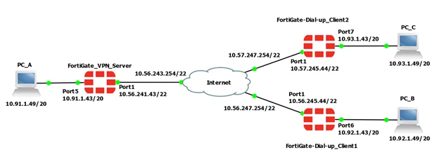

This article describes how to configure multiple FortiGates as IPsec VPN Dial-Up clients when the FortiGates are not behind a NAT unit.
Topology.
VPN Server Configuration.
Configure Interfaces.

  • Although a route-based IPsec tunnel has been created, it is not necessary to add a static route because it is a dialup VPN.
    FortiGate will dynamically add or remove appropriate routes to each Dial-up peer, each time the peer's VPN is trying to connect.

Verification.

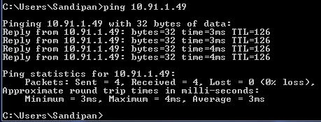

From PC_B ping a host on the server LAN subnet. The ping is successful.

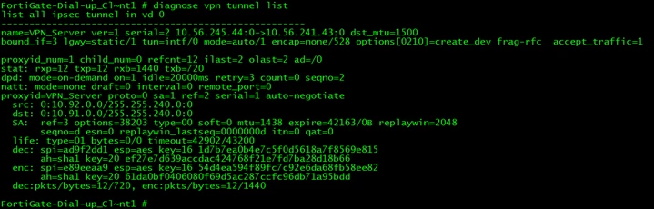

  • On 'FortiGate-Dial-up_Client1' go to Monitor -> IPsec Monitor to view the IPsec tunnel status.
  • On the 'FortiGate-Dial-up_Client1' CLI use the command 'diagnose vpn tunnel list' to view IPsec tunnel details.

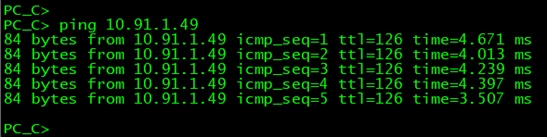

  • From PC_C ping a host on the server LAN subnet. The ping is successful.
  • On 'FortiGate-Dial-up_Client2' go to Monitor -> IPsec Monitor to view the IPsec tunnel status.
  • On the 'FortiGate-Dial-up_Client2' CLI use the command 'diagnose vpn tunnel list' to view IPsec tunnel details.

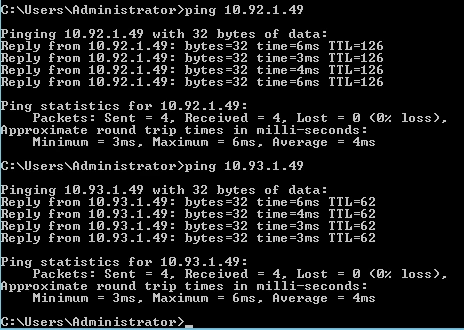

  • From PC_A ping hosts on the Dial-Up client’s LAN subnet. The pings are successful.

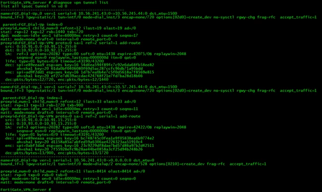

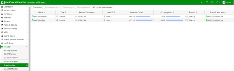

  • On 'FortiGate_VPN_Server' go to Monitor -> IPsec Monitor to view the IPsec VPN Dial-Up clients status.
  • On the 'FortiGate_VPN_Server' CLI use the command 'diagnose vpn tunnel list' to view IPsec tunnel details.
