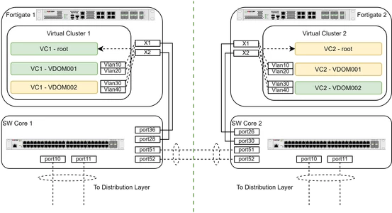

The example below shows 2 FortiGates configured in HA Active-passive mode, set with 2 vdoms in NAT mode and having Virtual clustering enabled.
Different vdoms are set to be primary on different virtual cluster partitions so both hardware resources are used.
The root vdom is also in NAT mode.
Virtual Cluster DiagramVirtual Cluster Diagram

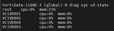

To verify a list of vdoms and the command 'diag sys vd stats' can be used in the Global context.
The example below lists the VC1VD004 before VC1VD003 and that's because of the index number.
diag sys vd statsdiag sys vd stats

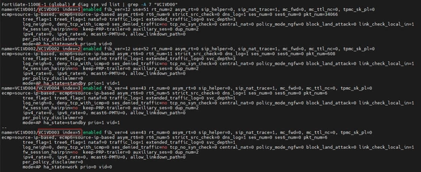

The command 'diag sys vd list' should provide detailed information where verification of the index of each vdom and that the index number sorts and controls a few other aspects as seen below.
diag sys vd listdiag sys vd list

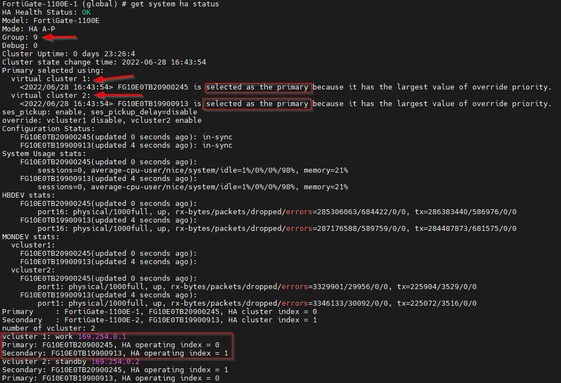

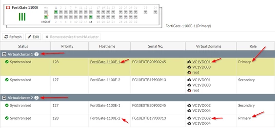

Using 'get system ha status' the configuration status can be verified which should always be 'in-sync' being updated frequently.
Notice the Virtual Cluster information where each hardware is primary for a determined virtual cluster containing one or more vdoms.
virtual cluster 1 = id 0 ( bit 0x0 )
virtual cluster 2 = id 1 ( bit 0x1 )
get system ha statusget system ha status
The GUI Dashboard should show the same output as above under System - > HA.
GUI HA DashboardGUI HA Dashboard

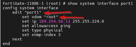

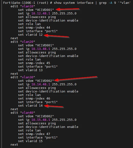

Using 'show system interface <interface name>' one can verify the interface settings and the vdoms to which the interfaces belong.
show system interface vlanshow system interface vlan
The parent and physical interface port1 is assigned to the root vdom.

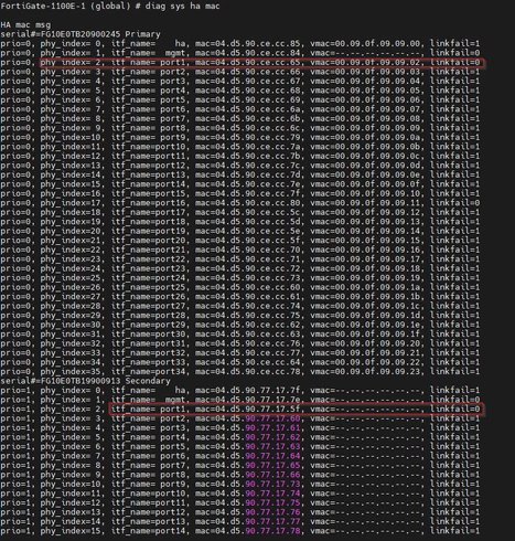

To verify the physical virtual and virtual MAC address from the physical interfaces, use 'diag sys ha mac' in the global context.
Notice that interfaces can only be linked to one vdom at a time, however, one vdom might not be linked to a virtual context ( Virtual Cluster ) where the primary unit is subject to change.
Let's note down the port1 phy_index and how the cluster controls the virtual mac between Primary and Secondary units.
Master  HW - diag sys ha macMaster HW - diag sys ha mac

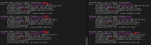

To verify the MAC address that's being sent in ARP replies on logical interfaces, use the command 'fnsysctl ifconfig <interface name>'.
Let's notice that the VLAN interfaces inherit the virtual mac from its parent's physical interface.
ifconfig interfacexxifconfig interfacexx

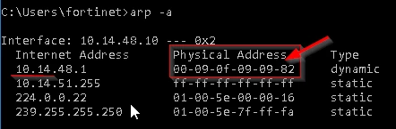

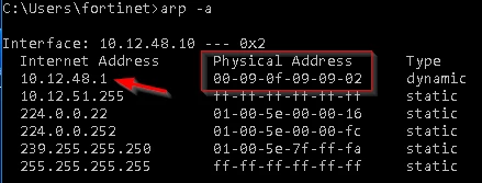

From the workstation's perspective, as vlan10 is active on virtual cluster1, it will learn the virtual mac address 00-09-0f-09-09-02.
arp  -aarp -a
However, from the workstation behind vlan30 which is active on virtual cluster2, it'll learn the virtual mac address 00-09-0f-09-82.
arp -aarp -a
Conclusion: when manually transitioning a vdom between vcluster1 and 2, the MAC address might change and this maneuver is considered a 'configuration change' and not a fail condition.
