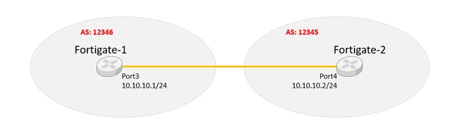

Consider the following topology:
BGP and BFD is up between FortiGate-1 and FortiGate-2.

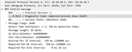

To remove the BFD dependency on BGP, configure 'set bfd disable' under the BGP neighbor configuration.
This will bring down the BFD neighborship, but will not bring down BGP as BFD uses 'Diagnostic Code: Administratively Down (0x07)'. This informs the neighbor that BFD is administratively disabled and not down due to reasons like keepalive being missing.

Admin Down PCAP:

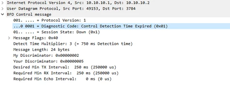

When keepalives are missed, BFD sends 'Diagnostic Code: Control Detection Time Expired (0x01)'. This will trigger BGP to go down.
Keepalive missing PCAP:
