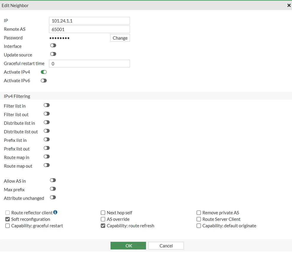

Once disabled, the enforce-first-as option soft clears the BGP particular neighbor and checks the routes.
execute router clear bgp ip <neighbor ip> soft
Note: For implementing soft BGP reset, make sure Soft reconfiguration is enabled on FortiGate BGP neighbor configuration. Most of the BGP configuration is the same as in a normal BGP setup. An IPsec VPN interface on the VXLAN interface setting should have net-device disable. It is also recommended to use this setup with VXLAN tunnel endpoints.
