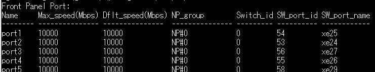

The mapping between ISF ports (Broadcom chip ports) and Front Panel ports can be verified using the following command.
In the example below, port1 is mapped to xe25 on the ISF.
diagnose npu np7 port-list
