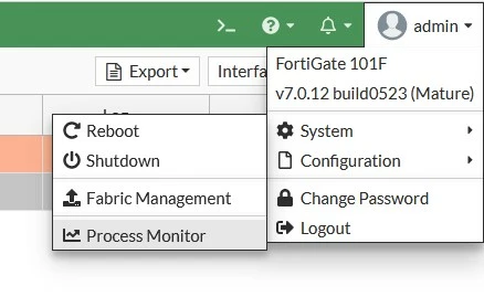

In the top right corner, select the username and then System -> Process Monitor.

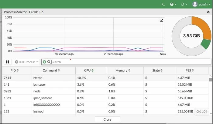

There, view the running daemons and the CPU and memory usage by each process.
To kill any process, right-click on the respective daemon, select Kill Process, and then one of the 3 available options:
- Kill: This is a standard process kill. It creates a one-line log message in the crashlog.
- Force Kill: Forces immediate termination, the same as the kill 9 signal. Can be viewed in the crashlog.
- Kill & Trace: The same as the kill 11 signal. Gives detailed crashlog information, required for further analysis. For example:
