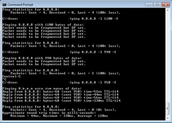

This article describes how to change the MTU value for LTE/modem interfaces.

# diag netlink interface list wwan
if=wwan family=00 type=1 index=24 mtu=1000 link=0 master=0
