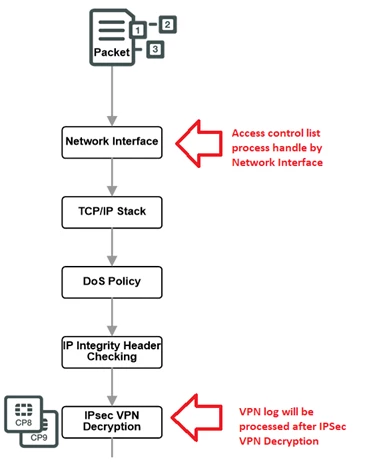

Partial packet flow ingress as shown below:

This article describes how to use access control list to avoid VPN generate log for IPSec blocked IP.
Access control list will be dropping the packet before it reach IPsec VPN decryption process, so no repeated VPN log can be seen for those IP blocked by access control list.
