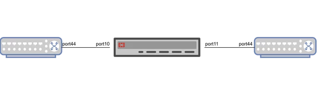

Example topology:

The following settings are used to enable layer 2 forwarding for the 2 interfaces used in the Virtual Wire Pair. In this example, port10 and port11 were used. It is also recommended to allow jumbo frames by increasing the MTU on the interfaces used as the 802.1AH used by the Extreme Switches will exceed the default 1500 MTU.
