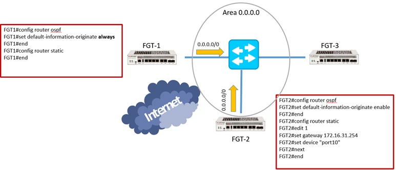

In the above topology, both FortiGate01 and FortiGate03 need to advertise the default route in the network.
FortiGate01 does not have a default route in its routing table, so the following configuration can be established on it to advertise the default route:
FortiGate01 # config router ospf
set default-information-originate always
FortiGate03 does have a default route in its routing table, and the following configuration can be done on it to advertise the default route:
FortiGate03 # config router ospf
set default-information-originate enable

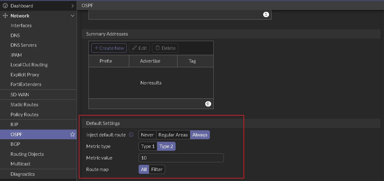

To configure the same on GUI, navigate to Network -> OSPF -> Default Settings:
The OSPF metric value and type of the default route being injected can be adjusted using the following commands:
config router ospf
set default-information-metric <metric value>
set default-information-metric-type <1/2>
