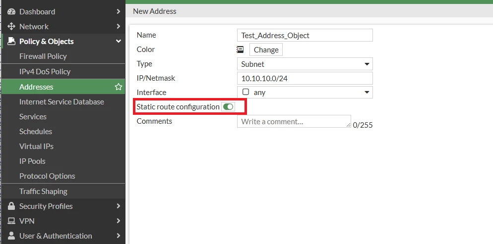

Configure an address object through the GUI under Policy & Objects -> Addresses, specifying the name, type, and subnet. Make sure to have the option 'Static route configuration' or 'Routing configuration' enabled, as this option will allow this Named address object to be used as a destination in static routes configuration.
GUI view:
  • In FortiOS v7.4.x and below, enable the 'Static route configuration' option while creating an address object and address group.

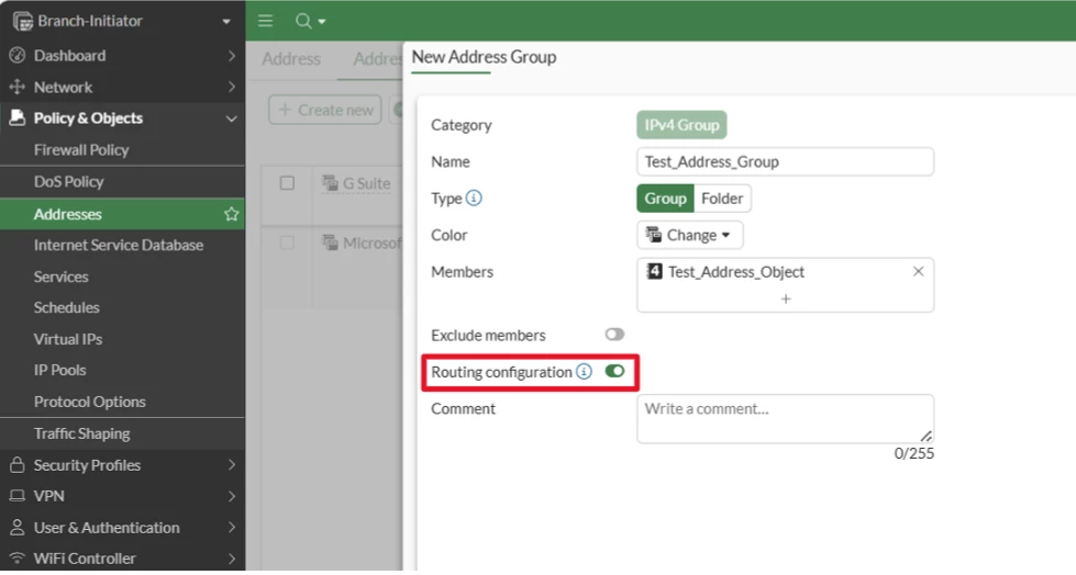

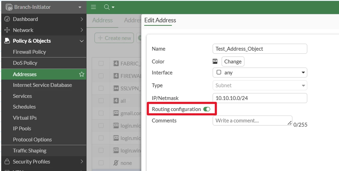

  • In FortiOS v7.6.x and above, enable the 'Routing configuration' option while creating an address object and address group.

config firewall address
    edit "Test_Address_Object"
        set uuid bc6f2364-f3b1-51f0-d076-f55395a71975
        set allow-routing enable       <-- Important to enable this configuration.
        set subnet 10.10.10.0 255.255.255.0
Configure an address group in the GUI under Policy & Objects, specifying the name and the members:
GUI view:
CLI view:
config firewall addrgrp
    edit "Test_Address_Group"
        set member "Test_Address_Object"
        set uuid 0fb59cd2-f3b3-51f0-ad39-1d2c3a984efa

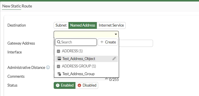

Now, selecting a named address while configuring a static route will show the named address object or named address group is available for selection.
GUI view:
CLI view:
lab # config router static
lab (static) # edit 10
new entry '10' added
lab (10) # set dstaddr
<string> please input string value
Test_Address_Object address        <--- Available address object.
Test_Address_Group addrgrp         <--- Available address group.
