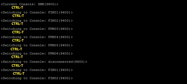

If connecting a PC to one of the management module console ports with a serial cable, open a terminal session by pressing Ctrl+T to enable console switching mode.
Press Ctrl+T multiple times to cycle through the FIM and FPM FortiOS CLIs (the new destination is displayed in the terminal window).
If Ctrl+T are pressed after connecting to the FPM in the highest slot number, the console disconnects. Press Ctrl+T again to start over again at slot 1.
Once the console port is connected to the desired CLI, press Enter to enable the CLI and login.
