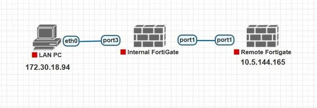

LAN PC is Doing SSH access of the External FortiGate (acting as a server) and traffic is passing through Internal FortiGate.

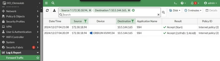

When SSH access is initiated in the PC and allowed by FortiGate, it will create a Forward traffic log in Internal FortiGate with service as SSH.
date=2024-12-27 time=04:20:39 eventtime=1735302038535839376 tz="-0800" logid="0000000013" type="traffic" subtype="forward" level="notice" vd="root" srcip=172.30.18.94 srcname="ERBIUM-KVM134" srcport=52132 srcintf="port4" srcintfrole="undefined" dstip=10.5.144.165 dstname="10.5.144.165" dstport=22 dstintf="port1" dstintfrole="undefined" srccountry="Reserved" dstcountry="Reserved" sessionid=10761106 proto=6 action="close" policyid=2 policytype="policy" poluuid="f1a56c7a-b57b-51ef-77b2-44d9c62a17a5" policyname="Internet policy" service="SSH" trandisp="snat" transip=10.5.144.159 transport=52132 appcat="unscanned" duration=106 sentbyte=2688 rcvdbyte=2460 sentpkt=16 rcvdpkt=15 vwlid=0 devtype="Unknown" osname="Windows" srcswversion="10 / 2016" mastersrcmac="00:65:72:62:86:01" srcmac="00:65:72:62:86:01" srcserver=0

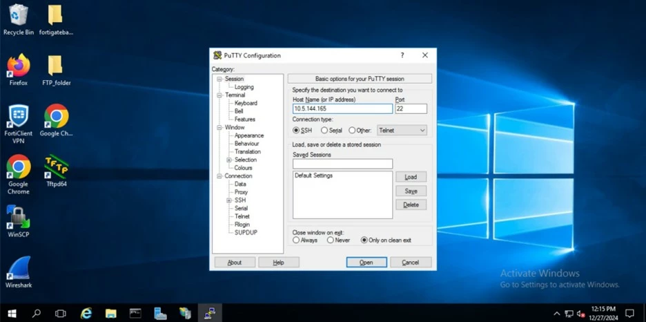

The same logs are generated in FortiGate irrespective of the client application used to initiate SSH access (TCP port 22).
Even when doing telnet to External FortiGate on TCP port 22 as well.
SSH or Telnet can be used to establish a TCP connection to the server listening port as 22. These two protocols will not share any protocol information in TCP handshake.

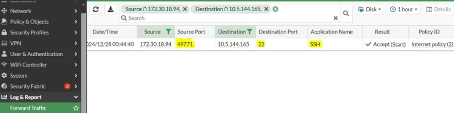

When FortiGate checks the incoming communication, for FortiGate, the destination port is TCP 22 which is a default port for SSH.
Now FortiGate matches this traffic with service SSH and allows the traffic.
If the communication is happening on TCP port 23, it will be understood that it’s a Telnet communication.
When telnet to server IP with any service port number such as 22, 80, 443 is generated, this will be match the respective protocol defined for these ports.

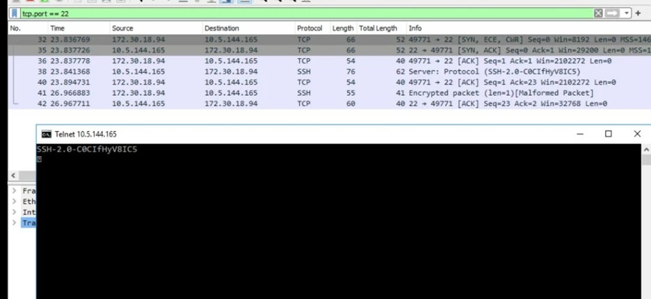

This is a sample communication from client to server using putty and connection types such as Telnet and port 22.
2997 1204.255690 172.30.18.94 10.5.144.165 TCP 66 52861 → 22 [SYN, ECE, CWR] Seq=0 Win=8192 Len=0 MSS=1460 WS=256 SACK_PERM
2998 1204.258657 10.5.144.165 172.30.18.94 TCP 66 22 → 52861 [SYN, ACK] Seq=0 Ack=1 Win=29200 Len=0 MSS=1460 SACK_PERM WS=16384
2999 1204.258696 172.30.18.94 10.5.144.165 TCP 54 52861 → 22 [ACK] Seq=1 Ack=1 Win=262656 Len=0
3000 1204.260725 10.5.144.165 172.30.18.94 SSH 76 Server: Protocol (SSH-2.0-ZiFqlIDFo8Qx)
3001 1204.263778 172.30.18.94 10.5.144.165 SSH 75 Client: Encrypted packet (len=21)
3002 1204.264246 10.5.144.165 172.30.18.94 TCP 60 22 → 52861 [ACK] Seq=23 Ack=22 Win=32768 Len=0
3058 1287.110313 172.30.18.94 10.5.144.165 TCP 54 52861 → 22 [FIN, ACK] Seq=22 Ack=23 Win=262656 Len=0
3059 1287.112673 10.5.144.165 172.30.18.94 TCP 60 22 → 52861 [FIN, ACK] Seq=23 Ack=23 Win=32768 Len=0
3060 1287.112708 172.30.18.94 10.5.144.165 TCP 54 52861 → 22 [ACK] Seq=23 Ack=24 Win=262656 Len=0
Both the Traffic is matches the service SSH and get allowed.
