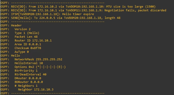

Troubleshooting steps:
diagnose ip router ospf all enable
diagnose ip router ospf level info
diagnose debug enable
Here is an example of the debug output:
