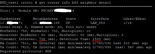

BFD_test1 has chosen the following timers:
  • Transmit Interval: 750 (ms).
  • Detection Time: 1500 (ms).

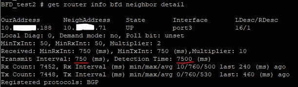

BFD_test2 has chosen the following timers:
  • Detection Time: 7500 (ms).
To verify it, use the command below:
get router info bfd neighbor detail
From BFD_test1 output:
BFD_test1
BFD_test1.
 From BFD_test2 output:
BFD_test2
BFD_test2
