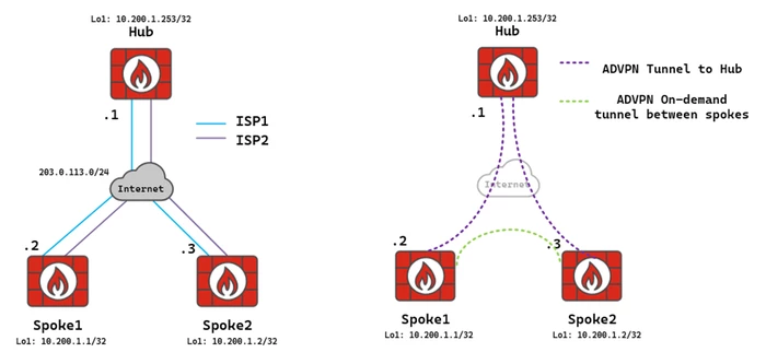

First, consider the previous version of ADVPN to understand the benefits of this new design. In the topology below, the Hub and Spoke use two internet links, ISP1 and ISP2. Both the Hub and Spoke have standard ADVPN and SD-WAN configurations applied.
Each spoke establishes two VPN tunnels to the Hub, and BGP peers using the tunnel IPs. Hub reflects the networks advertised by the spokes and an on-demand tunnel is established between the spokes when there is traffic between the LAN networks.

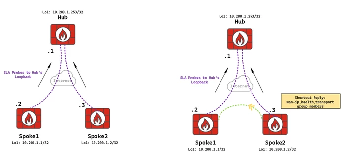

With the ADVPN 2.0 design, spokes can now share information about the health of the links. Based on this data, a spoke can select the optimal path and establish the shortcut tunnel to another spoke, considering local link health.
The initial setup is straightforward, with each spoke sending SLA probes to the Hub's loopback interface. During the shortcut tunnel negotiation, the shortcut reply includes this health information.

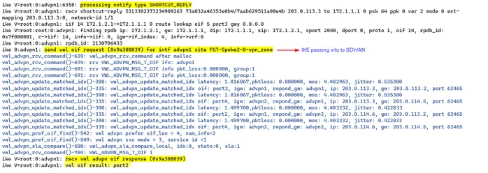

The originating spoke uses this data to decide which link to use for setting up the shortcut tunnel. In the below output, Spoke1 can see that in the shortcut reply, the health information is embedded by Spoke2. The SD-WAN process will use this information and inform IKE which interface to use for the shortcut tunnel.

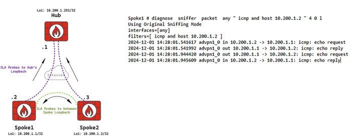

After the shortcut tunnel is in place, an ICMP probe (auto health check) is exchanged between the spokes.
This method provides more accurate health measurements compared to the previous approach, which relied on SLA probes to the Hub’s loopback. Based on the updated health information, the originating spoke can trigger a new shortcut tunnel if it detects a better path to another spoke.
