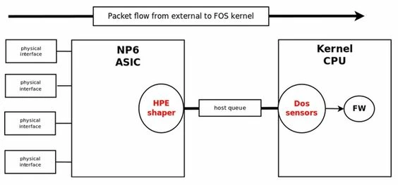

Packet flow.
NP6 HPE packet flow and host queues.
Configure HPE separately for each NP6 processor.
Each NP6 processor has multiple host queues, and each HPE packets-per-second setting is applied separately to each host queue.
The actual amount of traffic allowed by an HPE threshold depends on the number of host queues that each NP6 processor has.
