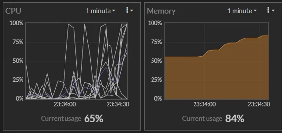

This article describes an issue where high CPU and memory utilization is observed on FortiGate devices when accessing large external threat feeds.
FortiGate v7.2.9.
When attempting to access external connectors configured with large external threat feeds, high CPU and memory utilization may occur due to the consumption of resources by the httpsd daemon on FortiGate devices.

This issue has been resolved in FortiOS v7.4.7 and v7.6.2.
