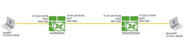

Consider the following topology:
The LocalFortiGate interfaces are configured with the default MTU value of 1500.

The RemoteFortiGate has port2 configured with MTU 1300 and port3 with MTU 1500.

An ICMP ping is initiated from the LocalPC towards the RemotePC with a packet length of 1350 bytes. This size exceeds the MTU of the RemoteFortiGate port2 interface (1300 bytes).
ping 10.123.3.193 -l 1350 -n 1
Since the LocalFortiGate MTU (1500) is higher than the packet length (1350), the packet is processed as expected.

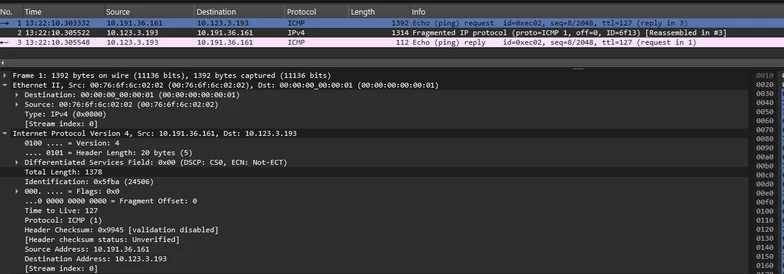

Packet captures taken from the port2 interface on the RemoteFortiGate display how the interface with a smaller MTU processes the larger packet.
  1. Packet 1: Confirms that the larger-sized packet (1392 bytes on wire) is accepted by the RemoteFortiGate on port2, despite the interface MTU being set to 1300.
  2. Packet 2 and Packet 3: Show that the reply packet is fragmented to respect the lower MTU value.
A configured lower MTU on an interface does not prevent the firewall from receiving or accepting a larger packet. The interface MTU setting restricts the size of packets the firewall transmits (egress), resulting in fragmentation or a drop (if the 'Don't Fragment' flag is set) if the packet exceeds the MTU value.
