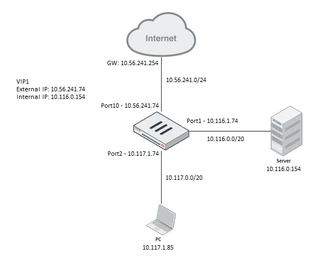

This article describes how to allow LAN Users to access the Servers using Public IP when the Hairpin NAT Policy is configured with Geo-IP Object in Source Field.

Debug flow When LAN Machine tries to access the Public IP:
id=20085 trace_id=36 func=print_pkt_detail line=5664 msg="vd-root:0 received a packet(proto=1, 10.117.1.85:2->10.56.241.74:2048) from port2. type=8, code=0, id=2, seq=18016."
id=20085 trace_id=36 func=init_ip_session_common line=5834 msg="allocate a new session-00037973"
id=20085 trace_id=36 func=fw_pre_route_handler line=181 msg="VIP-10.116.0.154:2, outdev-unknown"
id=20085 trace_id=36 func=__ip_session_run_tuple line=3427 msg="DNAT 10.56.241.74:8->10.116.0.154:2"
id=20085 trace_id=36 func=vf_ip_route_input_common line=2581 msg="find a route: flag=04000000 gw-10.116.0.154 via port1"
id=20085 trace_id=36 func=fw_forward_handler line=630 msg="Denied by forward policy check (policy 0)"
When using the Hairpin NAT, traffic is not leaving port10 to outside and coming back again to port10.  It might be thought that traffic leaves the FortiGate while Source is Natted to: 10.56.241.74.
