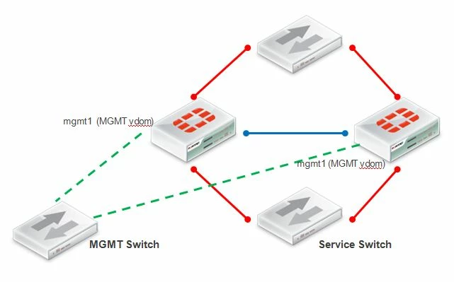

The HA Standalone Management Vdom provides a direct management access to cluster units by reserving a vdom specialized for management.
The port assignment to MGMT VDOM would be synchronized, however all config within the VDOM would not be sync'd.
User can login to any of the ports on each device and setup the IPs individually for the management VDOM.
This feature allows the Secondary units to send directly to syslog or SNMP server, etc.
It is recommended to use this interface for management purposes only. Creating VLAN interfaces on top of this interface, in other VDOMs, might cause unpredictable behavior, especially in VM environments.
As a similar feature, FortiGate has the HA Reserved Management Interface feature.
But HA Reserved Management Interface has some limitation for the remote syslog server.
When remote logging is configured, all cluster units send log messages to remote FortiAnalyzer units or other remote servers as configured. HA uses routing and inter-VDOM links to route subordinate unit log traffic through the primary unit to the network.
When HA Standalone Management Vdom is configured, it is available to verify which devices are sending the logs in syslog server.

From the syslog server, we can verify which IP is sending the logs by IP address.
Feb 17 16:06:44 192.168.1.99 date=2014-02-16 time=23:09:10 devname=FG3K9B3E13-----0 devid=FG3K9B3E13-----0 logid=0001000014 type=traffic subtype=local level=notice vd=MGMT srcip=192.168.1.103 srcport=137 srcintf="mgmt1" dstip=192.168.1.255 dstport=137 dstintf="MGMT" sessionid=865 status=deny policyid=0 dstcountry="Reserved" srccountry="Reserved" trandisp=noop service=137/udp proto=17 app=137/udp duration=0 sentbyte=0 rcvdbyte=0
Feb 17 16:06:44 192.168.1.100 date=2014-02-16 time=23:09:10 devname=FG3K9B3E10-----6 devid=FG3K9B3E10700346 logid=0001000014 type=traffic subtype=local level=notice vd=MGMT srcip=192.168.1.103 srcport=137 srcintf="mgmt1" dstip=192.168.1.255 dstport=137 dstintf="MGMT" sessionid=704 status=deny policyid=0 dstcountry="Reserved" srccountry="Reserved" trandisp=noop service=137/udp proto=17 app=137/udp duration=0 sentbyte=0 rcvdbyte=0
