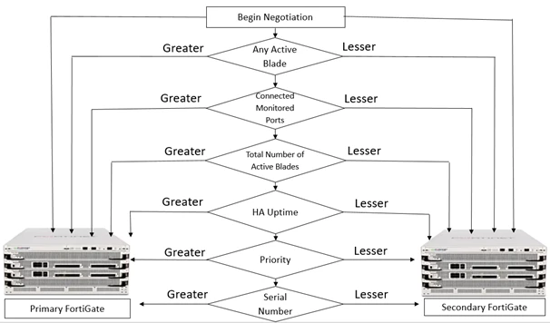

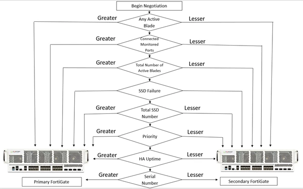

Case1: Override disabled.
When override is disabled, HA failover follows the below sequence:
6301/6501 Series: Any active worker (equal)-> Monitor interface (equal) -> Total active worker number (equal) -> SSD failure -> Total SSD number (equal) -> HA Uptime (equal) -> Priority (equal) ->Serial Number.
6300/6500/7000 Series: Any active worker (equal)-> Monitor interface (equal) -> Total active worker number (equal) -> HA Uptime (equal) -> Priority (equal) ->Serial Number.

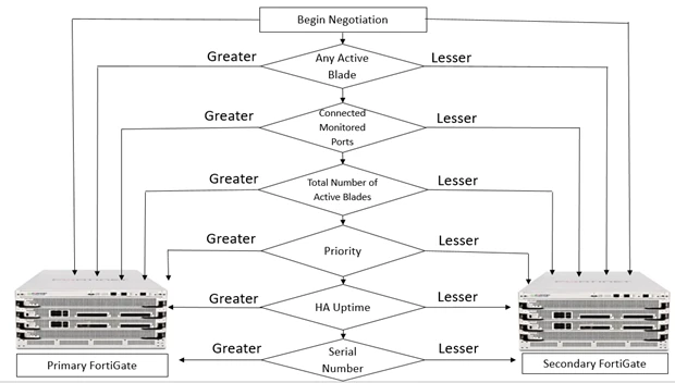

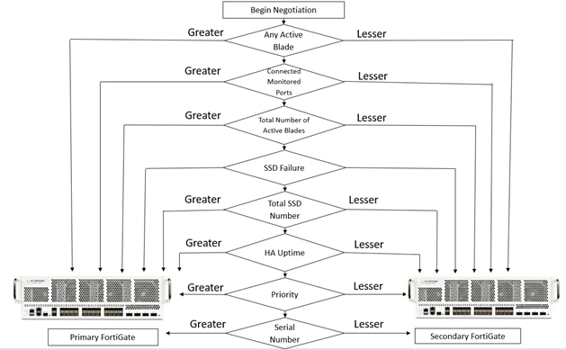

Case2: Override enabled.
When override is enabled, HA failover follows the below sequence:
6301/6501 Series: Any active worker (equal)-> Monitor interface (equal) -> Total active worker number (equal) -> SSD failure (equal) -> Total SSD number (equal) -> Priority (equal) -> HA Uptime (equal) ->Serial Number.
6300/6500/7000 Series: Any active worker (equal)-> Monitor interface (equal) -> Total active worker number (equal) -> Priority (equal) -> HA Uptime (equal) ->Serial Number.
