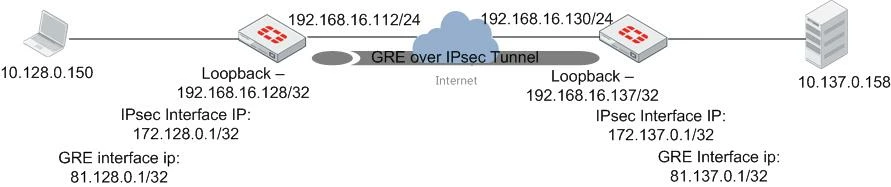

This article illustrates the configuration of a GRE over IPsec tunnel between FortiGate unit with IPsec tunnel to be terminated on a Loopback interface.
To deploy this configuration on the FortiGate unit, it is mandatory to configure different IP addressing space for the GRE tunnel and the IPsec tunnel. Further more, Loopback interface IP need an egress point to reach peer device (static route).
In this particular setup, IPsec encapsulation needs to be configured in Tunnel Mode (Transport Mode is not supported) and allow-subnet-overlap at system settings needs to be enable.
Network Diagram

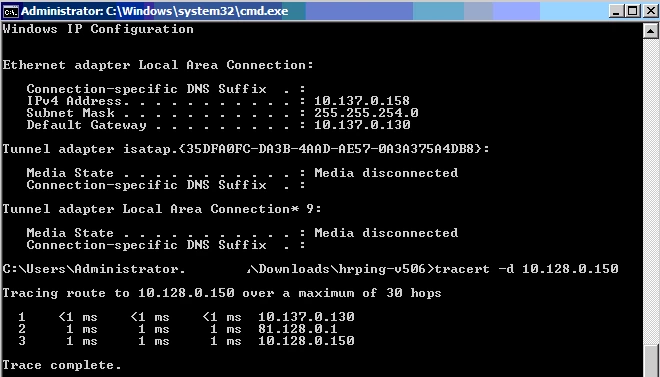

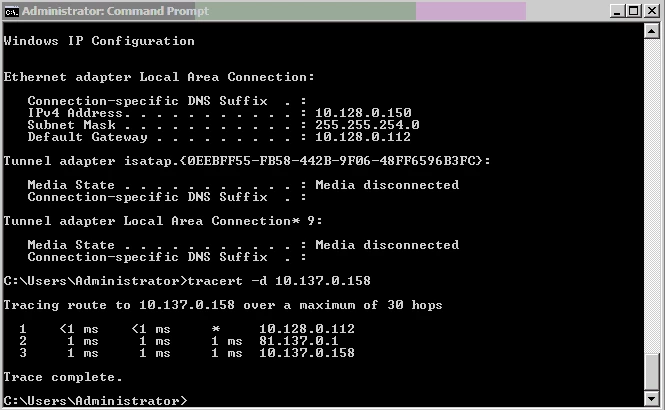

Trace route results:-
