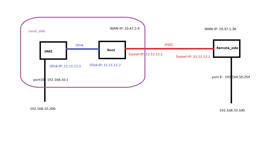

The workaround is to configure 2 VDOMs, with IPSec terminated in 1 VDOM and GRE terminated in another VDOM.
For example:
  • Root VDOM is used to establish VPN to the remote side.
  • DMZ VDOM is used to establish GRE tunnel to remote side.
