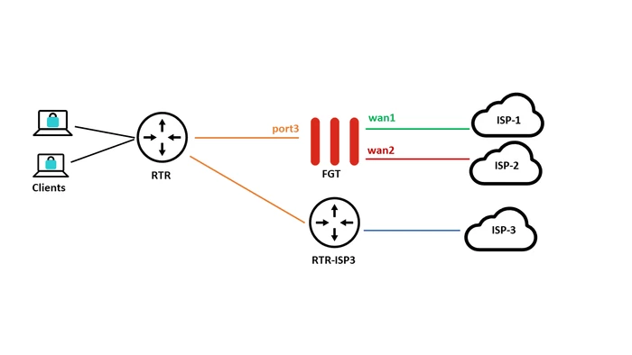

Below is a setup example where Cascade Interface may be used:
In this case, if both members of SD-WAN are down, port3 as the cascade interface will go down. This will make the switch consider that path as 'dead', meaning it will therefore send traffic to the other device and the internet.
