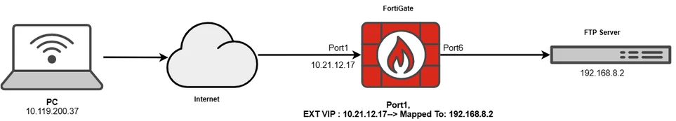

In the example below, the PC client is located outside the network and attempts to access an internal FTP server behind the FortiGate firewall.
Topology:
The session below was created for the control plane communication for FTP over port 21. The traffic is forwarded from port 1 to port 6.

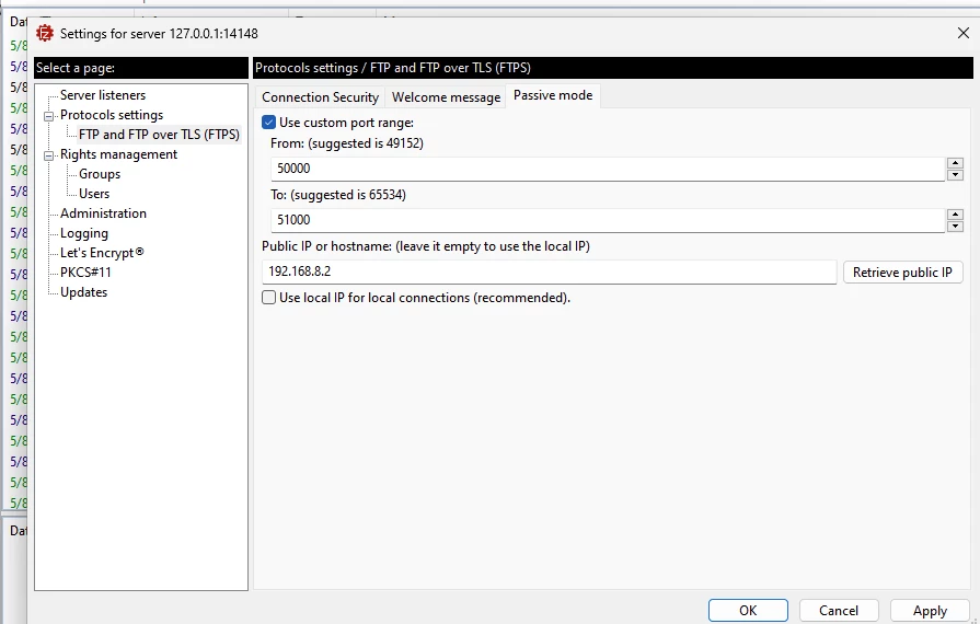

  • Configure the FTP server to use its local IP address in passive mode:
    For example, in the FileZilla server application, configure the local IP under Protocols settings -> FTP and FTP over TLS -> Public IP or hostname.
Once either of these methods is applied, FTP data traffic should pass as expected.
