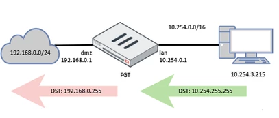

This article describes how to forward broadcast traffic from one interface (subnet) to another interface (subnet).
Network Diagram:
Network diagramNetwork diagram
Scope FortiGate.
The solution is to use a VIP object to replace one subnet broadcast address with another.
An essential part of the configuration is to enable broadcast-enable on the ingress interface.
Example configuration:
