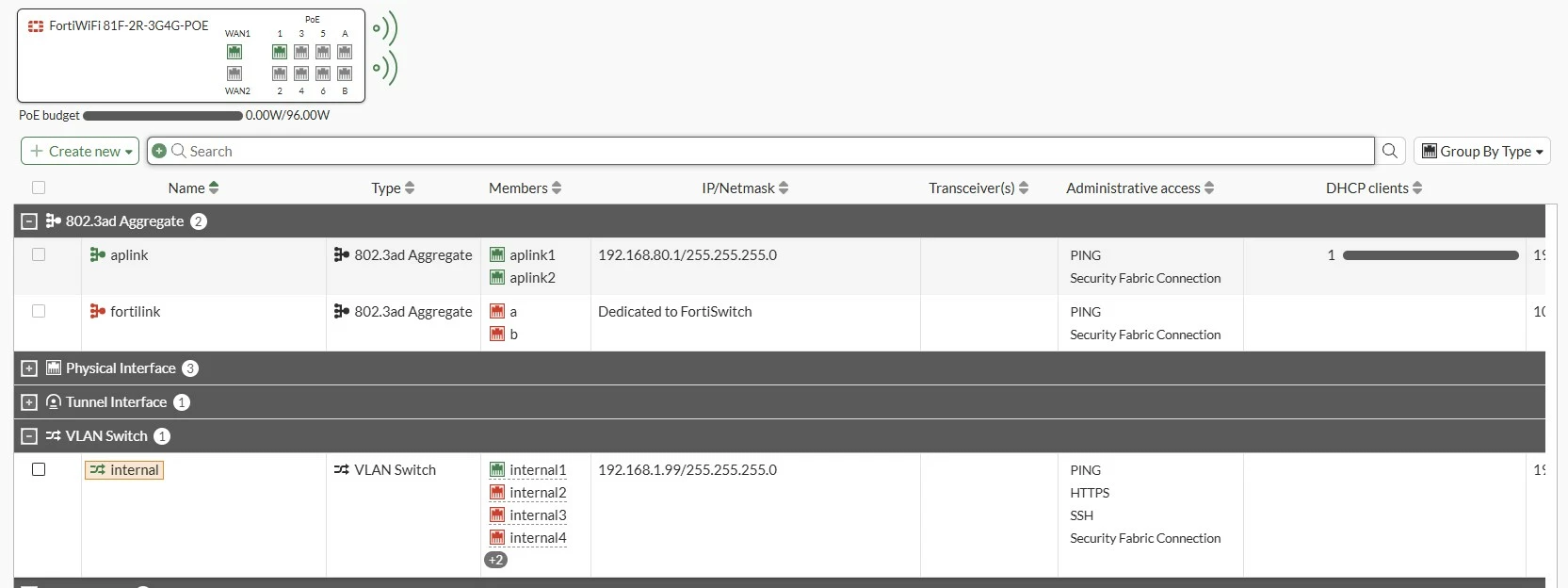

Below is the snapshot taken from the FortiOS 7.6.4 default configuration, where the aplink1 interface is a member of the aplink aggregate interface.

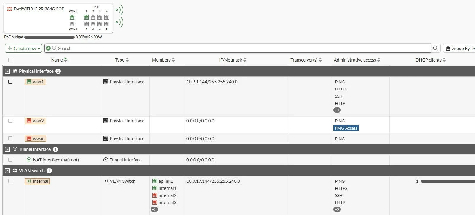

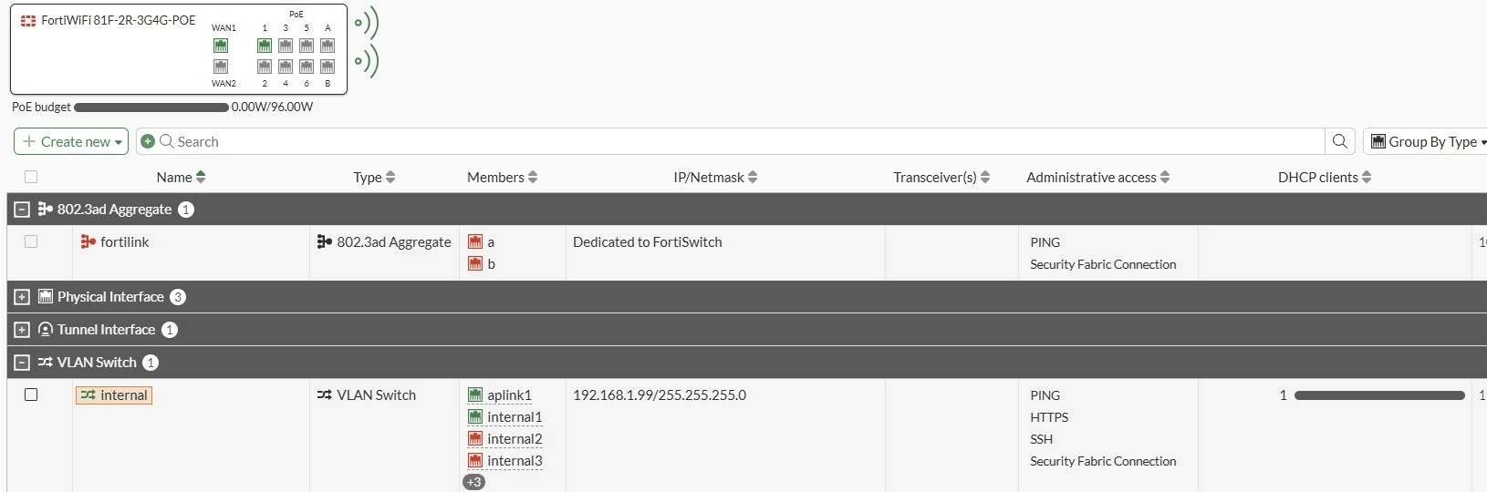

In FortiOS 7.6.5, the aplink1 interface membership has been moved to the internal hardware switch instead of the aplink aggregate interface. This change applies only to devices using the factory‑default configuration in these versions.
When upgrading from a previous release such as FortiOS 7.6.4, where aplink1 was already part of the aplink aggregate interface, the existing configuration is preserved and migrated as is—meaning aplink1 remains a member of the aplink aggregate interface.
