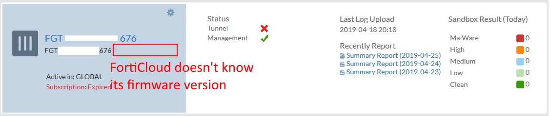

FortiCloud doesn’t show FortiGate firmware version as follows:

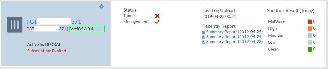

To trigger the FortiGate to update its firmware version info, please run the following CLI command:
 di fdsm log-controller-update
 di fdsm contract-controller-update
FortiCloud now shows FortiGate firmware version as follows:
