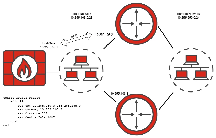

Example Topology:
FortiOS v7.4.7 and earlier:
In this example, the static route for the remote network 10.255.250.0/24 is redistributed into BGP.

config router static
edit 99
set dst 10.255.250.0 255.255.255.0
set gateway 10.255.108.3
set distance 211
set device "vlan108"
