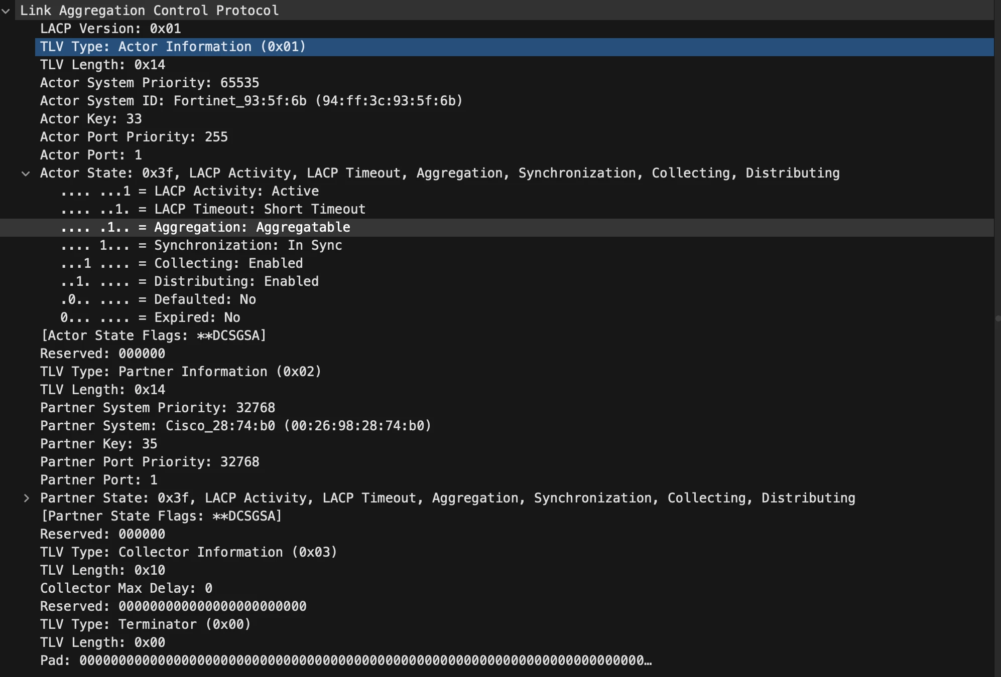

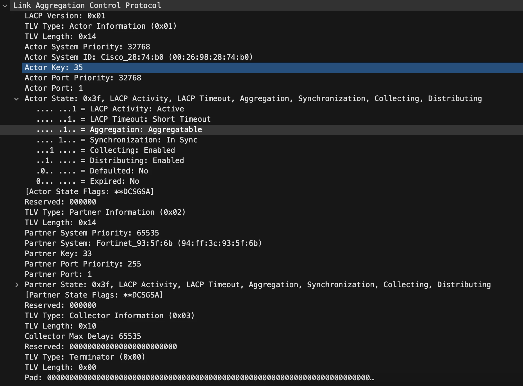

An example of a LACPDU frame between a FortiGate and a Cisco router:
LACPDU sent by the FortiGate:
LACPDU sent by the Cisco router:
When the number of available links drops below the value set in min-links, the FortiGate will disable the LAG interface and stop sending traffic through it.
Nevertheless, it will keep sending LACPDUs through the still available ports (if any) as before. There are no changes in the flags of these LACPDUs.
As a consequence, the remote LAG will not be disabled, since it is still receiving the LACPDUs from at least one active port and min-links is a local (non-standard) setting, and this will cause downtime.

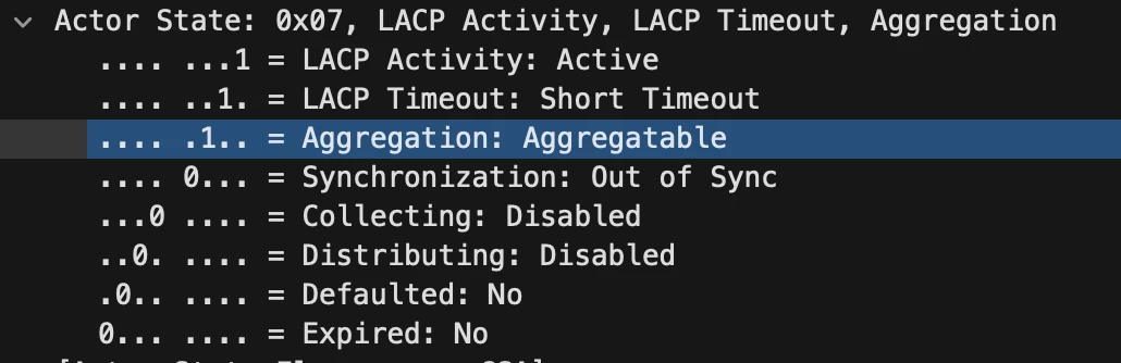

Some of the other vendors implementing this feature chose to change some flags in the LACPDU when the minimum number of interfaces drops below the number set in min-links.
Here is an example of one of these implementations and what the changed flags are (more on the meaning below):
- Synchronization.
- Collecting.
- Distributing.
This set of flags will provoke the remote LAG interface to go down, making sure that the LAGs on both sides are down. This means that if a FortiGate is connected to a device implementing min-links in this way, its own LAG would be disabled.
This is not a bug but simply a difference in implementations, since min-links are not actually a standard, and the aforementioned changed flags are not related to the LAG interface itself but rather to the aggregated interfaces themselves individually. From the standard:
'The Synchronization flag indicates that the transmitting participant’s mux component is in sync with the system id and key information transmitted. This accommodates multiplexing hardware that takes time to set up or reconfigure. If set the flag communicate In Sync, if reset Out of Sync.
The Collecting flag indicates that the participant’s collector, i.e. the reception component of the mux, is definitely on. If set the flag communicates collecting.
The Distributing flag indicates that the participant’s distributor is not definitely off. If reset the flag indicates not distributing.'
