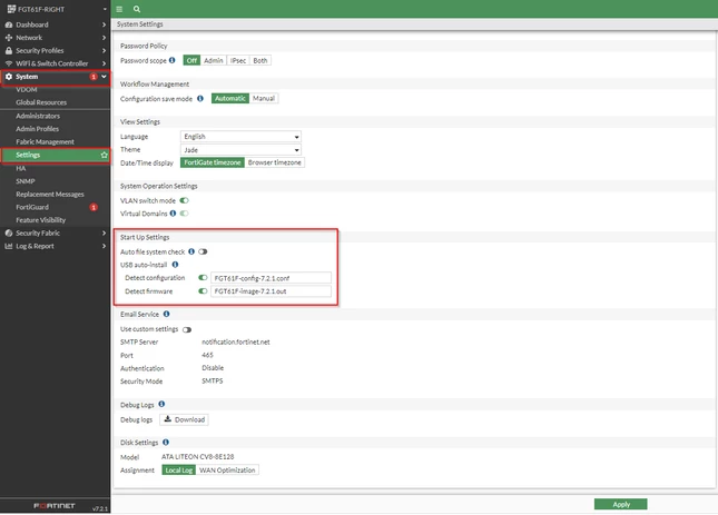

  2. Check whether the automatic USB firmware and configuration installations are enabled in the config. The auto install of the config in USB disk is disablde by default. To verify this in the GUI, navigate to System -> Settings -> the 'USB auto-install' section:
Alternatively, set it from the CLI:
config system auto-install
    set auto-install-config enable
    set auto-install-image enable
    set default-config-file "fgt_system.conf"
    set default-image-file "image.out"
