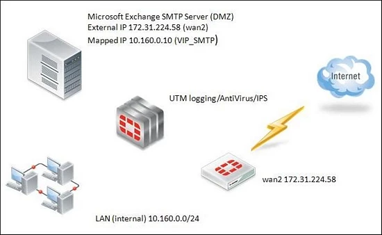

Network Scenario:
  • Microsoft Exchange Server deployed on the DMZ interface of the FortiGate.
  • SMTP deployment.

  1. Create a Virtual IP to map external to internal traffic towards the Microsoft Exchange server.
config firewall vip
    edit "VIP_SMTP"
        set extip 172.31.224.58
        set extintf "wan1"
        set mappedip 10.160.0.10
