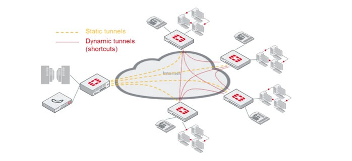

- Fortinet Auto Discovery VPN (ADVPN) allows to dynamically establish direct tunnels (called shortcuts) between the spokes of a traditional Hub and Spoke architecture.
- After a shortcut tunnel is established between two spokes and routing has converged, spoke to spoke traffic no longer needs to flow through the Hub. Direct connectivity is provided.
- ADVPN requires the use of dynamic routing in order to function and supports both BGP and RIPv2. This recipe will focus on using RIP v2 and its route-reflector mechanism as the dynamic routing solution to use with ADVPN.
- ADVPN’s primary advantages is that it provides the full meshing capabilities to a standard hub and spoke topology, greatly reducing the provisioning effort required for full spoke to spoke low delay reachability and addressing the scalability issues associated with very large fully meshed VPN networks.
Diagram:
