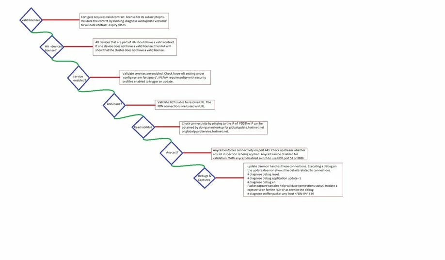

FortiGuard Troubleshooting.

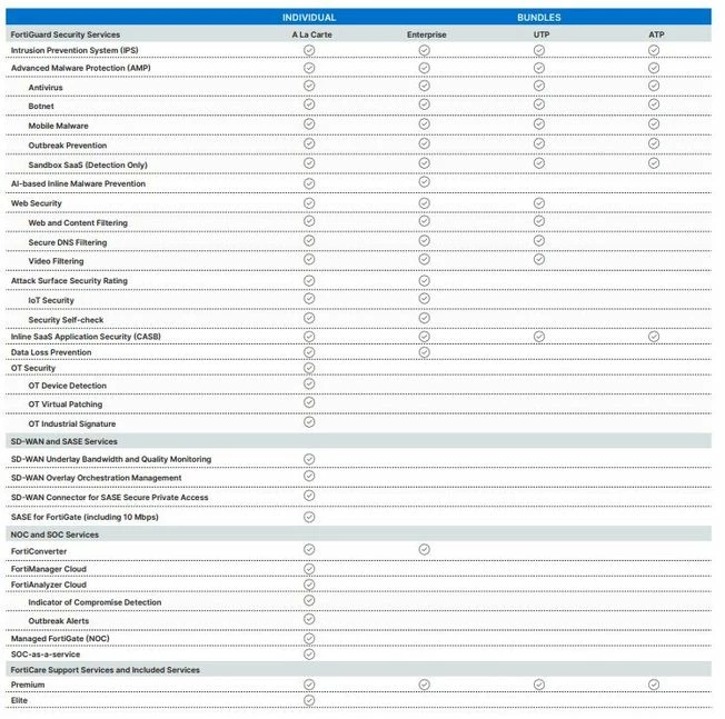

FortiGuard Subscriptions/Services:
The details of FortiGuard services and subscriptions are available at FortiGuard Service Offerings.

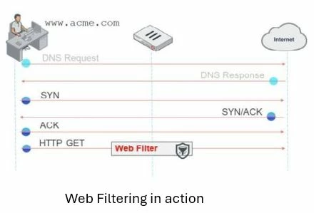

Live Querying:

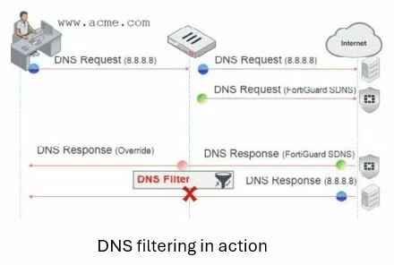

Live querying is carried out by features that use category-based filtering, such as the Web Filter and DNS Filter. Each request must be checked against FDN to determine the appropriate category of the domain being requested. To boost efficiency, the URL/domain classification is cached.
The category dictates whether the connection is refused or authorized, depending on the action defined for the category in the relevant Security Profile. If anycast is enabled, it connects to globalguardservice.fortinet.net, otherwise to service.fortiguard.net. It communicates via TCP port 443 with Anycast enabled.
However, if anycast is disabled, this can be changed to utilize the UDP port 53/8888. If the location is specifically configured to connect to the United States, for example, the connection is forwarded to usguardservice.fortinet.net. Live querying necessitates continuous connectivity to FDN and a valid service license.
If the license expires, a two-day grace period is provided. After that, initiated requests will be blocked unless the functionality is turned off.

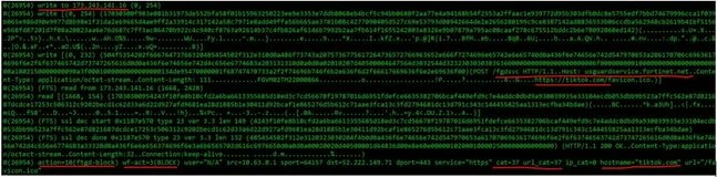

Below is a sample debug of the flow-based web filter categorization request and the FortiGuard response. The debug commands used are below, execute from management VDOM:
diagnose debug reset
diagnose debug application urlfilter -1
diagnose debug enable
To stop the debug:
diagnose debug disable
If the traffic volume is too much, the debug output can be restricted by filtering based on the source IP of the client machine.
diagnose debug urlfilter src-addr <IP address>

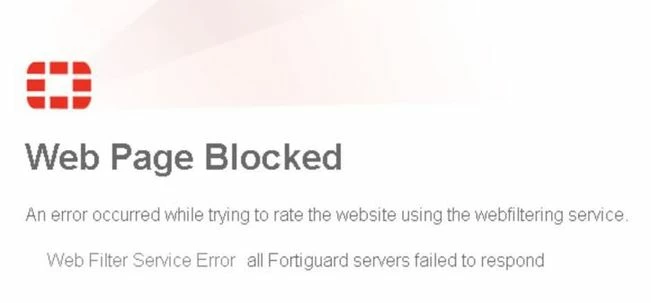

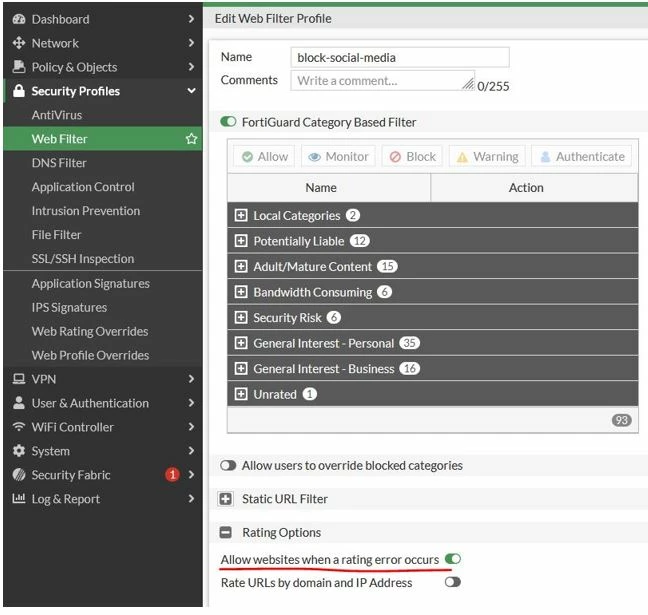

If live queries to categorize a URL fail, site access is blocked by default. This could be due to connectivity issues with FDN/FortiGuard or an expired web filter service license. End users may encounter an error in the browser as shown below.
In these situations, enable the option ‘Allow websites when a rating error occurs’ as shown below under the security profile so that the websites are not blocked. The same option is available for DNS filtering security profiles as well.
If the rating error occurs due to connectivity issues with FortiGuard, checking the following points would be helpful:

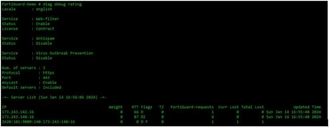

Live Querying - Rating Server availability:
The FortiGuard server that the FortiGate is connecting to can be checked by issuing the command:
diagnose debug rating
The above implies that the web filter license is under contract and enabled. With Anycast enabled, communication goes through port 443. If there is a connectivity issue, the 'Curr Lost' figure will continue to increase. The 'RTT' indicates the round-trip time.
When Anycast is disabled, the number of IP addresses or servers seen on the command above is usually high, 10+. There are scenarios where DNS responses limit the number of servers.
Accordingly, a weight is allocated. A server is picked based on its weight and RTT values.
For a thorough understanding of how a certain server is selected from the list, see this article: Troubleshooting Tip: Resolving FDS Communication Issues (FortiGuard Distribution Servers).
If the command diagnose debug rating is used during FortiGuard rechability troubleshooting, it is necessary to remember that after the connection problem with FortiGuard is solved, some traffic must be received from the FortiGate and matched by a firewall policy, using, for example, webfiltering, to see the output of the command updated, with webfilter status passing from 'Disable' to 'Enable'.

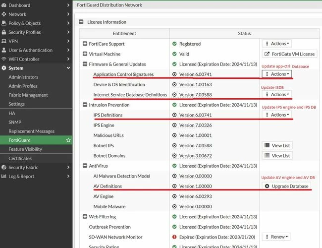

Verify whether the packages being used are signed by Fortinet by using the following commands:
diagnose autoupdate signature check-all
diagnose autoupdate versions

Packages can be upgraded directly from the GUI.
The example shown above demonstrates various options to update packages. The IPS engine and IPS Database are updated using the same 'Action' tab against IPS. This is the same case for antivirus engines and antivirus databases as well.
The same can be achieved through the CLI using the following command:

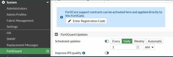

Scheduling Package Updates:
Updating definitions can cause a momentary increase in CPU usage. Updates can be scheduled during off-peak hours when network usage is at a minimum to ensure that network activity will not be affected.
In the CLI, this can be configured under:
config system autoupdate schedule
The default setting is automatic and keeps checking every few hours.
A schedule of once a week means any urgent updates will not be pushed until the scheduled time. If an urgent update is required, select the Update Licenses & Definitions Now button to manually update the definitions.

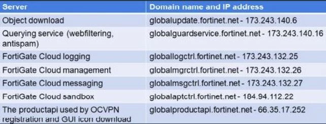

  1. service.fortiguard.net (without anycast) or globalguardservice.fortinet.net (with anycast).
  2. UDP (53 or 8888)/TCP (443).

  1. update.fortiguard.net (without anycast) or globalupdate.fortinet.net (anycast).
  2. TCP port 443 (SSL).

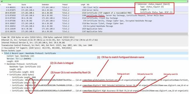

The default FortiGuard access mode is Anycast. It enforces SSL connections on port 443 and validates them using the OCSP (Online Certificate Status Protocol) stapling check. FortiGate gets a single IP for the domain name of each FortiGuard service. It improves routing efficiency by connecting to the nearest server. With Anycast enabled, FortiGate terminates a connection with FortiGuard if any of the following conditions apply:
  1. The CN in the server certificate does not match the domain.
  2. The OCSP's status is not good.
  3. The issuer's CA is revoked.
Below is an example Wireshark capture that shows the OCSP check:
Below are a few connection URLs that FortiGate uses when Anycast is enabled:

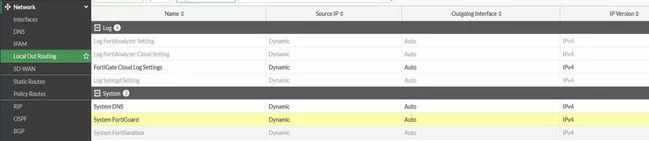

The SD-WAN rule will only take effect once the interface-select-method is set to SD-WAN. The same can be done from Local-Out-Routing: go to Network -> Local Out Routing to configure the available types of local out traffic.
By default, Local Out Routing is not visible in the GUI. Go to System -> Feature Visibility to enable it. From the CLI, the interface-select-method can be chosen as SD-WAN.

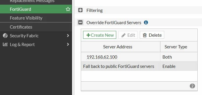

FortiGuard Licensing through FortiManager:
FortiManager can act as a local FortiGuard server. The FortiGate connects to FortiManager instead of directly connecting to FDN over the Internet.
    set type fortimanager
    set fmg "192.168.62.100"
        config server-list
                set server-type update rating
                set server-address 192.168.62.100
The server-type helps decide whether FortiManager handles live querying, package updates, or both.
When fmg-update-port is set to 443, the update process will use port 443 to connect to the override update server, which is the local FortiGuard server in the FortiManager. If this is not set, the update process will use port 8890.

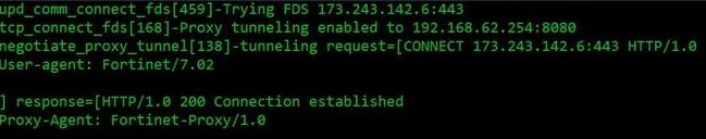

A FortiGate unit can use a proxy server to connect to the FortiGuard Distribution Network (FDN). The configuration for this can only be set up through the CLI:
config system autoupdate tunneling
    set status enable
    set address "192.168.62.254"
    set port 8080
In v7.6.3 and above, the 'config system autoupdate tunneling' command has been removed and replaced with 'config system fortiguard'.  See: Changes in CLI
    set proxy-server-ip <proxy_address>
    set proxy-server-port <proxy_port>
FortiGate connects to the proxy server using the HTTP CONNECT method on the configured port number.
The proxy server must not inspect the HTTPS traffic used for FortiGate communication.
FortiGate sends to the proxy server an HTTP CONNECT request that specifies the IP address and port required for the FDN connection. The proxy server establishes the connection to FDN and passes information between FortiGate and FDN.
Debugging the update daemon would show the following logs for connectivity with the proxy server:
The connect request here is for an IP and not a URL because the URL is resolved by the FortiGate system DNS.
If the system DNS fails to resolve the URL, the connection request would be for the URL directly.

Below is a flowchart intended to demonstrate how to troubleshoot FortiGuard issues. Click on the image to enlarge it.

This highlights an issue related to an SSL connection. Check if any SSL inspection is done upstream. Packet capture also helps to verify if the SSL handshake is being completed successfully. Alternatively, disable Anycast and use UDP port 53/8888.
The following are the key points to consider while troubleshooting FortiGuard-related issues:
  1. Validate the device license using the 'diagnose auto update versions' command.
  2. Validate that every device in the cluster has a valid contract.
  3. Verify services are enabled. For example, AV and IPS updates are triggered when they are applied at the policy level. Make sure force-off settings are not enabled under 'config system fortiguard'.
  4. Validate that the FortiGate can resolve URLs using its system DNS.
  5. Check reachability to the FDN by performing a simple ping.
  6. If a TCP or SSL connection is not getting established, validate upstream whether any devices are doing inspection or filtering connections.
  7. Troubleshoot using the update daemon debug logs and by performing a packet capture if required.
