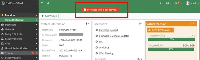

This article explains the reason behind the 'FortiGate time is out of sync' header message displayed in the GUI, even when the NTP status is synced.

Added a platform warning in the header to let the user know that the FortiGate time is out of sync with real time when manual time is set and it is off by more than two minutes.
Hence, if the system time is set manually to reduce the time difference between the client system and FortiGate to below 2 minutes, it will remove the header message 'FortiGate time is out of sync' from the GUI. Check also whether the computer machine on which the FortiGate is being accessed is in the same time zone; if the computer machine time is different from the FortiGate's set time zone, it will also show the time is out of sync.
When the system time is set to NTP, switching to manual and matching the 'Current system time' with the time in the computer will work as a temporary workaround; the time difference might reappear if the time is set back to NTP.

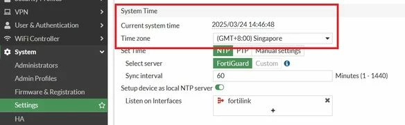

To verify the FortiGate's current system time via the GUI, simply go to System -> Settings

Root Cause:
This message is not based solely on NTP sync status. It appears when:
  • FortiGate system time differs by more than 2 minutes from the local client (browser) time.
  • FortiGate is manually set to a system time not aligned with the client's time zone or real-time clock.
  • Time zone differences between FortiGate and the accessing client may also cause this if not interpreted correctly by the browser.
A large time discrepancy could impact services, such as intermittent VPN connections, because certificates may appear expired and the FortiGate may be unable to contact the FortiGuard server. A power outage at the site could also cause the time to become misaligned. If the system's current time and the computer's time are already synced, try to refresh the browser and check again. This issue can occur after a firmware upgrade.
