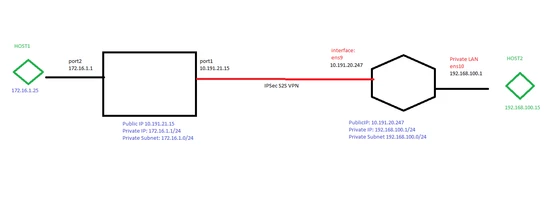

Logical Topology for Site-to-Site VPN between FortiGate and Strongswan in Ubuntu Server 20.04:
Ubuntu 20.04
Public IP ens9: 10.191.20.247/20
Private IP ens10: 192.168.100.1/24

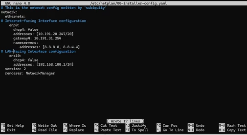

After installing an Ubuntu server, it is necessary to set up IP addresses
Setup an IP address on Ubuntu Server
This setup will depend on the Ubuntu version and account level. This article assumes root access is available.

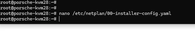

For any changes using the 'nano' editor, save the config with Ctrl+O and exit with Ctrl+X:
nano /etc/netplan/00-installer-config.yaml
Set up configuration as below:
This is the network config written by 'subiquity':
network:
  ethernets:
# Internet-facing Interface configuration
    enp9:
      dhcp4: false
      addresses: [10.191.20.247/20]
      gateway4: 10.191.31.254
      nameservers:
         addresses: [8.8.8.8, 8.8.4.4]
# LAN-facing Interface configuration
    ens10:
      dhcp4: false
      addresses: [192.168.100.1/24]
  version: 2
  renderer: NetworkManager
After, save the config with Ctrl+O and exit with Ctrl+X.
Apply network changes using the following:
netplan apply

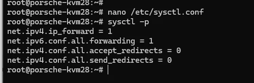

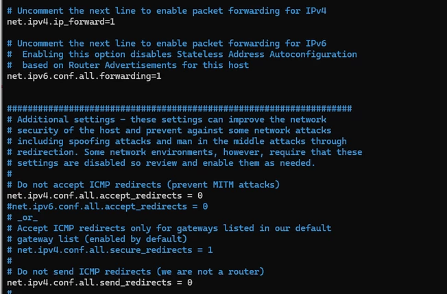

In order for Ubuntu to serve as a router in the setup, it is necessary to enable Kernel Packet Forwarding:
nano /etc/sysctl.conf
Uncomment these 4 lines:
net.ipv4.ip_forward = 1
net.ipv6.conf.all.forwarding = 1
net.ipv4.conf.all.accept_redirects = 0
net.ipv4.conf.all.send_redirects = 0
Next, apply this change with the following:
sysctl -p

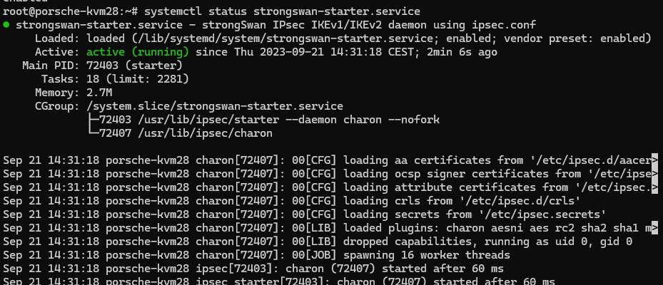

Enable Strongswan service:
systemctl is-enabled strongswan-starter.service
Check Strongswan service where the status should be active and running:
systemctl status strongswan-starter.service

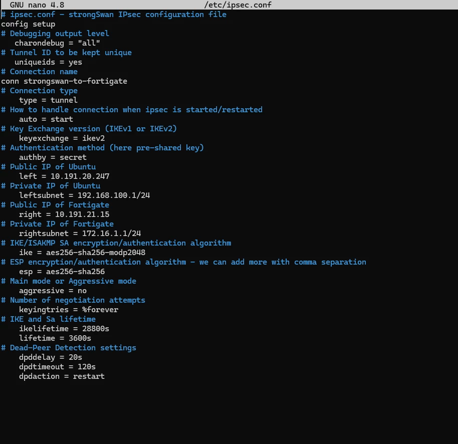

Now, create an IPsec VPN:
Create a backup of the config file with the following:
cp /etc/ipsec.conf /etc/ipsec.conf.bakfile
Then edit the original file with the desired settings:
nano /etc/ipsec.conf
# ipsec.conf - strongSwan IPsec configuration file
config setup
   charondebug = "all"
   uniqueids = yes
conn strongswan-to-fortigate
    type = tunnel
    auto = start
    keyexchange = ikev2
    authby = secret
    left = 10.191.20.247
    leftsubnet = 192.168.100.1/24
    right = 10.191.21.15
    rightsubnet = 172.16.1.1/24
    ike = aes256-sha256-modp2048
    esp = aes256-sha256
    aggressive = no
    keyingtries = %forever
    ikelifetime = 28800s
    lifetime = 3600s
    dpddelay = 20s
    dpdtimeout = 120s
    dpdaction = restart

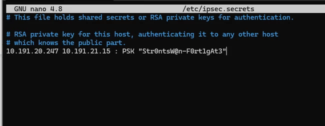

Now, it is necessary to specify the secret key. There are multiple methods from automatically generating them to setting them manually.
This guide will demonstrate with a simple key, Str0ntsW@n-F0rt1gAt3 <- Use the strong key here.
nano /etc/ipsec.secrets

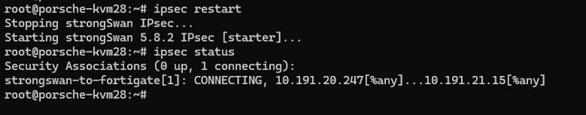

Restart Strongswan and check its status:
ipsec restart
ipsec status
Strongswan will try to connect but will not succeed because the FortiGate has not been configured yet.

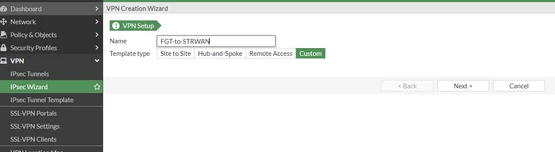

  1. Start IPsec Wizard and create a Custom VPN:

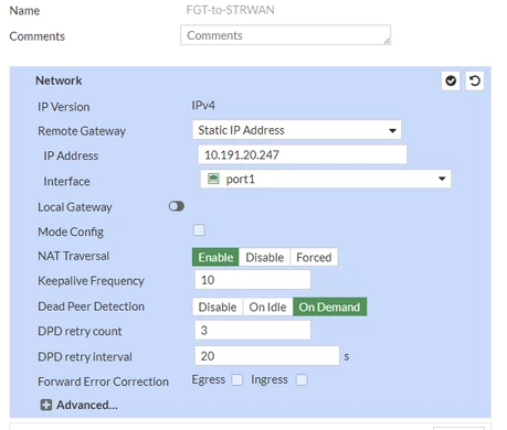

  1. Configure Remote Peer, Interface, and DPD Settings:
  1. Setup Preshared Key and IKE Version:

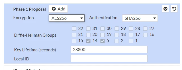

  1. Setup Phase1 settings:

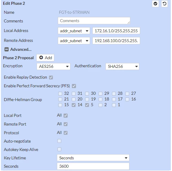

  1. Setup Phase2 settings:
The same results can be accomplished using the CLI:
    edit "FGT-to-STRWAN"
        set interface "port1"
        set ike-version 2
        set keylife 28800
        set peertype any
        set net-device disable
        set proposal aes256-sha256
        set remote-gw 10.191.20.247
        set psksecret ENC *********
        set phase1name "FGT-to-STRWAN"
        set keylifeseconds 3600
        set src-subnet 172.16.1.0 255.255.255.0
        set dst-subnet 192.168.100.0 255.255.255.0

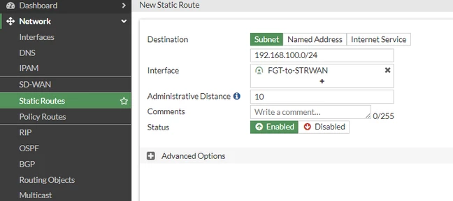

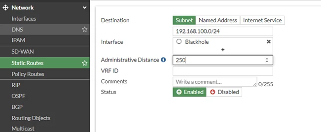

Create a Static Route to reach to 192.168.100.0/24:
Do not forget a blackhole route with a high Administrative Distance:
