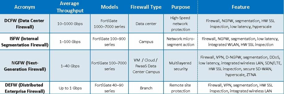

Scope FortiGate, DCFW, NGFW, ISFW, DEFW.
Match the Firewall to Its Intended Role:
Each FortiGate model is designed for specific deployment roles. Aligning the model and its functions with the intended role is both beneficial and effective.
Fortinet provides performance metrics and capabilities for comparison purposes, helping to support the sizing process.

For a strategic firewall selection, the Fortinet Product Matrix should be compared with the current and future operational requirements of the project/environment.
Resources, including CPU, RAM, concurrent sessions, and the throughput for SSL inspection, firewalling, IPsec VPN, IPS, NGFW, and threat protection, must be carefully considered.
Deploying the FortiGates respecting the designated role will prevent performance issues and unforeseen events.
