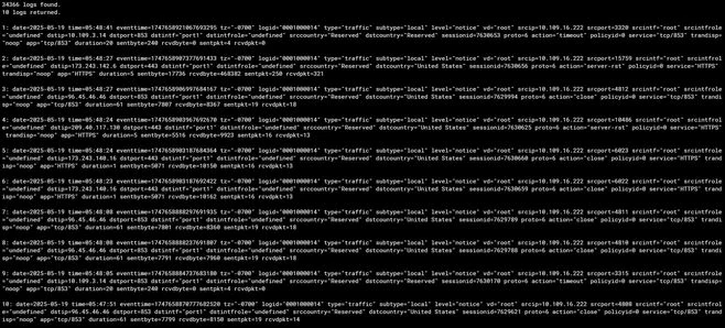

Sometimes the high memory usage can be due to logging to memory; it can be filter in same or similar manner as disk.
FW3 # exec log filter device 0  <----- Filtered to internal memory.
FW3 # exec log display  <----- Will display 10 logs by default and show the total , as shown below.
FW3 # exec log delete
If this workaround succeeds, the 'freeable' memory (get sys perf status) should go down in a minute or two. Same for the 'Cached' memory in 'diagnose hardware sysinfo memory'.
