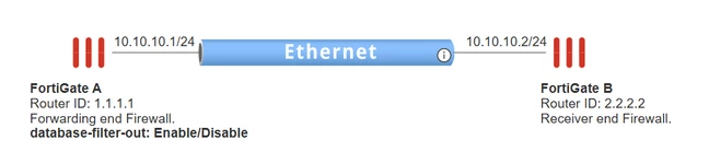

Network Setup:
Step 1: Review OSPF Interface Configuration on FGTA.

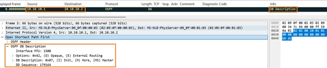

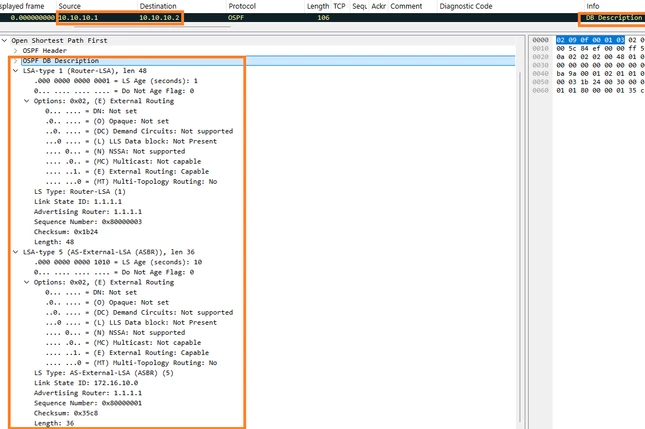

Packet Capture Analysis on FortiGate A:
Before Enabling 'database-filter-out':
LSA Headers Present:
  • Type 1 (Router-LSA), ID: 1.1.1.1.
  • Type 5 (AS-External-LSA), ID: 172.16.10.0.
After Enabling 'database-filter-out':
  • No LSA Headers Present.
  • Flags: Init, More, Master.
