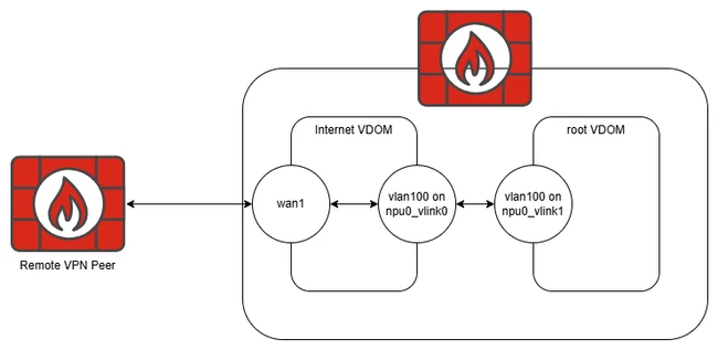

As part of this design, administrators may consider configuring their VPN tunnels to listen/terminate on these NPU VDOM links. The following is an example of what this topology might look like:
However, there is a known issue that occurs when IPsec VPN tunnels are configured to listen on NPU VDOM links or associated VLANs (for example, the issue would occur in the above topology if the VPN tunnel was set to listen on vlan100 in the root VDOM). In this configuration, the VPN tunnel will appear to be fully offloaded to the NPU, but in actuality, it will be handled entirely by the CPU.
