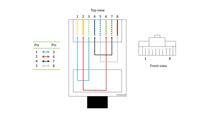

The Self-loopback cable is a special wired cable where the TX lane and RX lanes are 'looped' as illustrated below:

During HQIP Tests, it may be required to plug a 'SELF-LOOPBACK' into interfaces so they can be tested, and in the example below, the HA port should receive a self-loopback cable while the other ports should be plugged into each other as described.
dia hardware test network
Network Interface Loopback Test - Please connect ethernet cables:
[HA - SELF-LOOPBACK] [MGMT - Any of PORT1...PORT16] [PORT17 - PORT18] ... [PORT23 - PORT24] [X1 - X2] [x3 - x4]
Do you want to continue this test? (y/n) (default is n) y
If it is necessary to plug a self-loopback cable during the HQIP test, use a cable with the technical specifications above.
The HQIP test checks the ports at 1000Mbps speed. If this speed is not achieved, ensure the loopback connection has all 4 wire pairs connected.

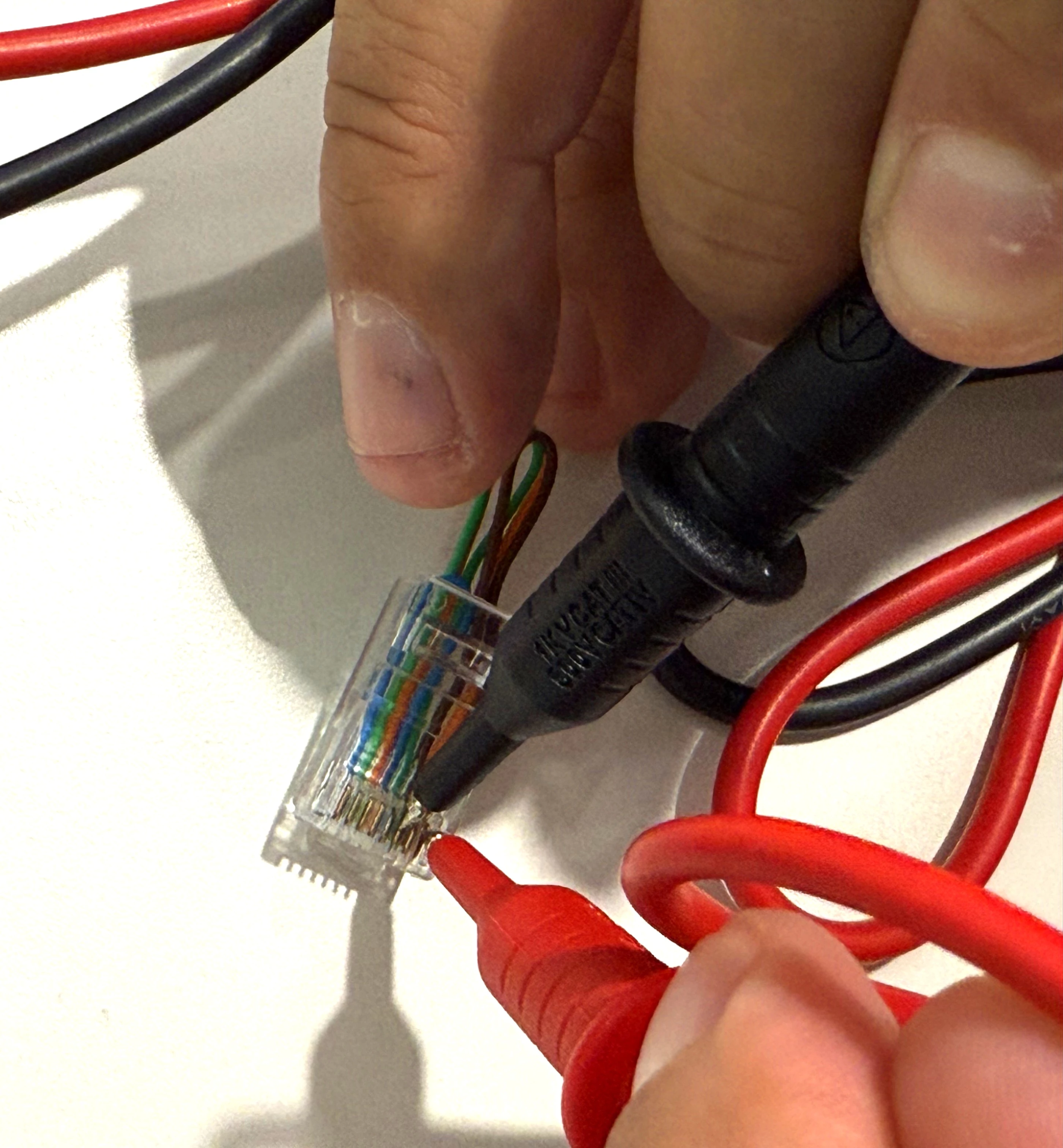

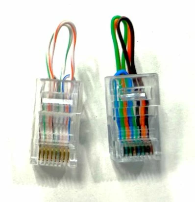

With a UTP cable, it will be possible to elaborate two Self-loopbacks and see them as in the following images:

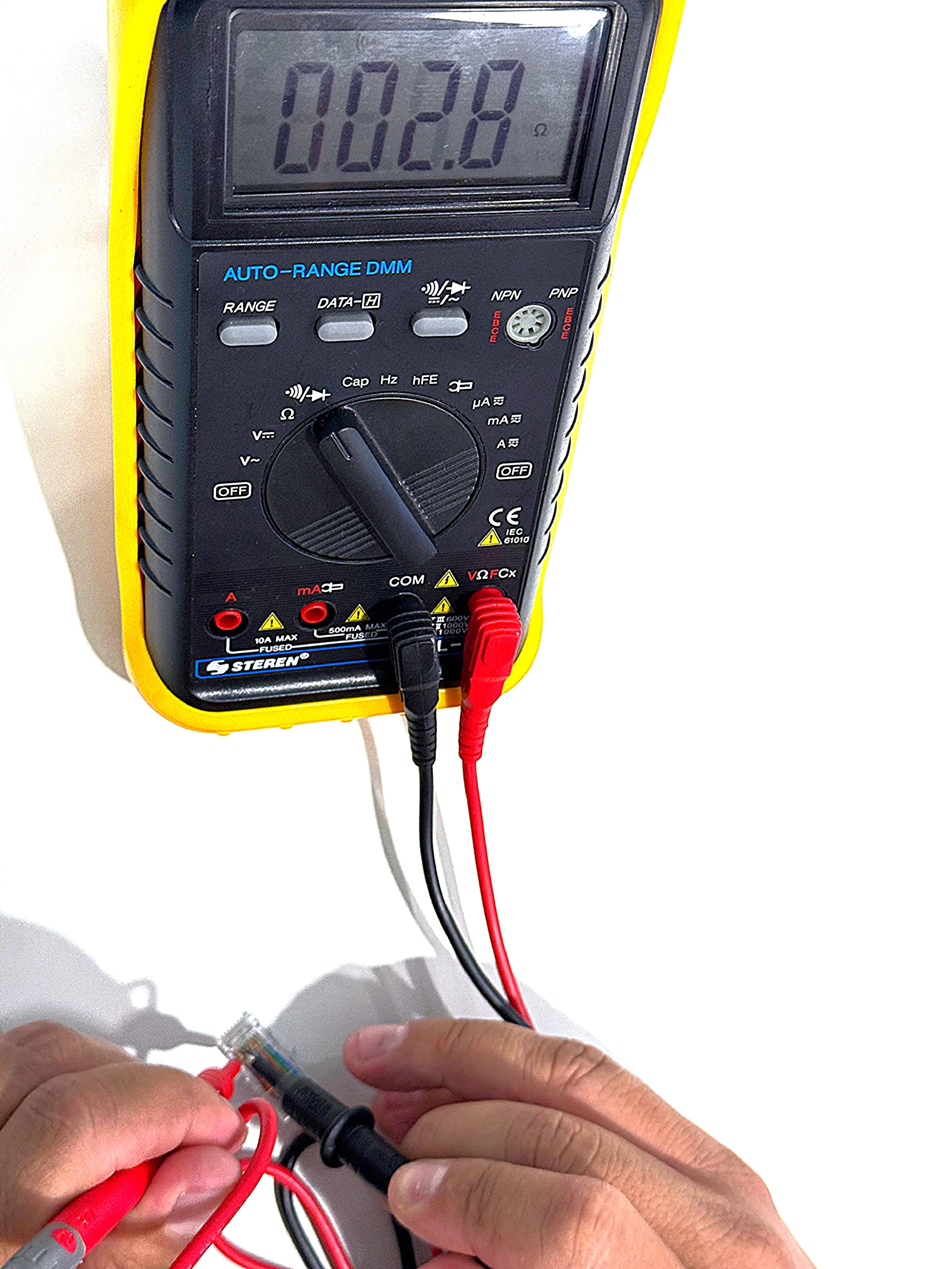

Note: Any time a Self-loopback cable is created, it needs to be tested with tester or multimeter in order to above diagram in the top of this article accomplish voltage continuity.
