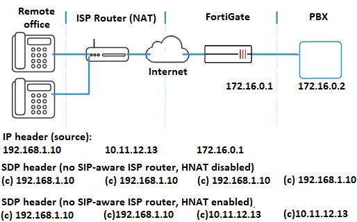

HNAT is a solution offered for SIP clients who directly connect from a remote location behind a router (ISP, MPLS, etc.) that performs NAT to the all the traffic, including SIP, but without being aware of the SIP content (and therefore not changing it as it is expected).
This will cause problems in the process of SIP handling (phones unable to register, one-way audio).
Diagram of the SIP communication w/o HNAT:
Note: The FortiGate with SIP-ALG or an SIP session-helper enabled (and HNAT disabled) may still perform SNAT to the SDP header in this case. So the IP of 192.168.1.10 may not be propagated to the PBX. Instead, the public (or local IP) of the FortiGate interface may replace this IP in the SDP header.

Via: 192.168.1.11:5060                     <- This is the local IP of the phone in the private network of the client. This should be the public IP of the client (10.11.12.13).
From: 12345@10.11.12.13                    <- This is OK.
Contact: 12345@192.168.1.11:65432
Body:
(o): ……. IN IP4 192.168.1.11 <- As these IPs are not public, FortiGate or PBX will not know how to route the traffic back without enabling HNAT
(c): IN IP4 192.168.1.11 <-
