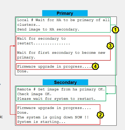

The following is the general process that occurs when performing a firmware upgrade on an HA cluster with uninterruptible-upgrade enabled:
  • The administrator uploads the firmware image to the Primary device.
  • The Primary node pushes the image to the other members of the HA cluster (i.e., the Secondary units).
  • The Secondary units upgrade their firmware and reboot as part of the process. After the upgrades are completed, the Secondary units send the Primary an acknowledgment that the upgrade has been completed.
  • After receiving acknowledgement, the Primary node starts the upgrade and reboots. During this reboot, one of the Secondary units will assume the HA Primary role. Traffic will failover from the former HA Primary to the new HA Primary. (Note: To understand which sessions are transferred from the primary unit to the new active unit during an HA failover, refer to the article: Technical Tip: HA session failover (session pickup).
  • After the upgrade process is completed, the old Primary will rejoin the cluster. Depending on the HA settings/status (e.g., cluster uptime, whether or not HA override is enabled, etc.), the original Primary may or may not resume as the HA Primary for the cluster.

Stage 1: Upgrade starts.
Primary:
2023-02-22 12:33:03 <hatalk> entering hatalk_upgrade_timer_func: uprade_state=1(ENTER), daemon_bits=0x00000000
2023-02-22 12:33:03 <hatalk> leaving hatalk_upgrade_timer_func: uprade_state=2(PRIMARY), daemon_bits=0x00000000
2023-02-22 12:33:03 Send image to HA secondary.
2023-02-22 12:33:06 <hatalk> leaving hatalk_upgrade_timer_func: uprade_state=3(SENT-IMAGE), daemon_bits=0x00000000
Secondary:
2023-02-22 12:33:04 Get image from ha primary OK.
2023-02-22 12:33:04 Verifying the integrity of the firmware image...
2023-02-22 12:33:05 Check image OK.
2023-02-22 12:33:05 Please wait for system to restart.
2023-02-22 12:33:13
Firmware upgrade in progress ...
Done.
The system is going down NOW !!
Stage 2: After the Secondary FortiGate has completed its reboot/firmware upgrade, the HA cluster will failover the HA Primary role so that the Primary FortiGate can undergo the upgrade.
Primary:
2023-02-22 12:33:12 <hatalk> leaving hatalk_upgrade_timer_func: uprade_state=4(CHECK-SECONDARY), daemon_bits=0x00000000
2023-02-22 12:34:01 <hatalk> new member 'FGVM020000-----6' is added into group
2023-02-22 12:34:03 <hatalk> entering hatalk_upgrade_timer_func: uprade_state=14(WAIT-DAEMONS), daemon_bits=0x00000170
2023-02-22 12:34:03 <hatalk> check_daemon_wait: ClearPass sync is done, daemon_bits=0x00000070
2023-02-22 12:34:18 <hatalk> entering hatalk_upgrade_timer_func: uprade_state=5(SECONDARY-UP), daemon_bits=0x00000000
2023-02-22 12:34:18 <hatalk> leaving hatalk_upgrade_timer_func: uprade_state=6(RELEASE-UPGRADE-FLAG), daemon_bits=0x00000000
2023-02-22 12:34:19 <hatalk> leaving hatalk_upgrade_timer_func: uprade_state=7(RELEASE-DONE), daemon_bits=0x00000000
2023-02-22 12:34:19 Wait for first secondary to become new primary
2023-02-22 12:34:20 <hatalk> entering hatalk_upgrade_timer_func: uprade_state=8(CHECK-STATE), daemon_bits=0x00000000
2023-02-22 12:34:20 <hatalk> vcluster_0: state changed, 2(work)->3(standby)
2023-02-22 12:34:20 <hatalk> [hatalk_work_as_slave:391] vcluster_0: work_as_secondary
2023-02-22 12:34:21 <hatalk> leaving hatalk_upgrade_timer_func: uprade_state=9(BECOME-SECONDARY), daemon_bits=0x00000000
Secondary:
2023-02-22 12:34:21 <hatalk> vcluster_0: set flag HATALK_VMEMBER_F_CLAIM_AS_PRIMARY
2023-02-22 12:34:21 <hatalk> cfg_changed is set to 1: hatalk_work_as_master
2023-02-22 12:34:21 <hatalk> vcluster_0: update state_change_time, work-as-primary
Primary (after Secondary has assumed the HA Primary role):
2023-02-22 12:34:30
Done.
