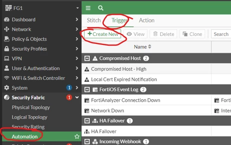

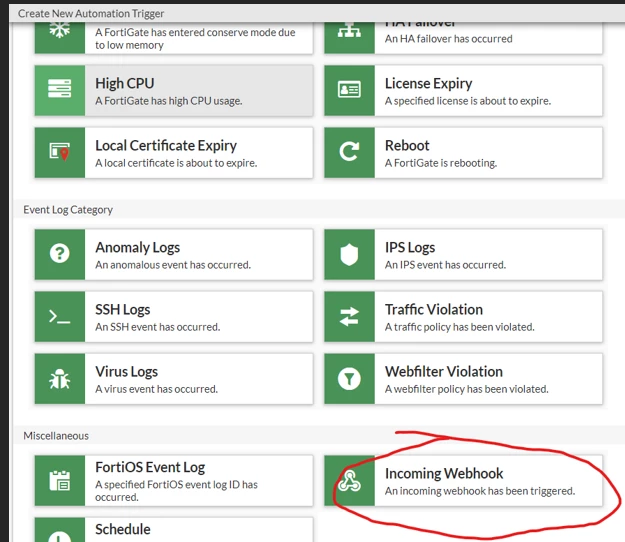

Step 1: Create trigger.

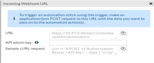

Choose webhook and provide a name:
URL for webhook is created and select 'OK':

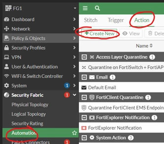

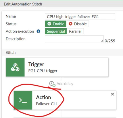

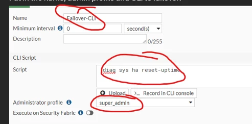

Step 2: Create Action:

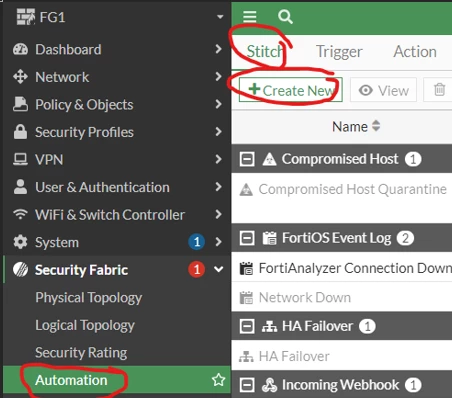

Step 3: create a stitch.

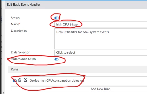

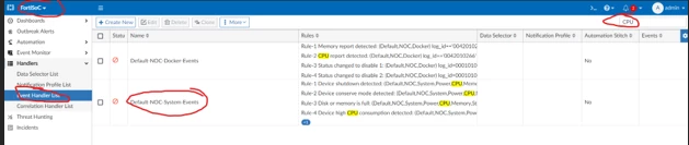

Step 1: Create an event handler for CPU usage under FortiSoC -> Event Handler and search for CPU:
'Right-click' 'Default-NOC-System-Events' and clone. Edit the cloned Event handler by enabling status, change meaningful name and remove all the rules except CPU:

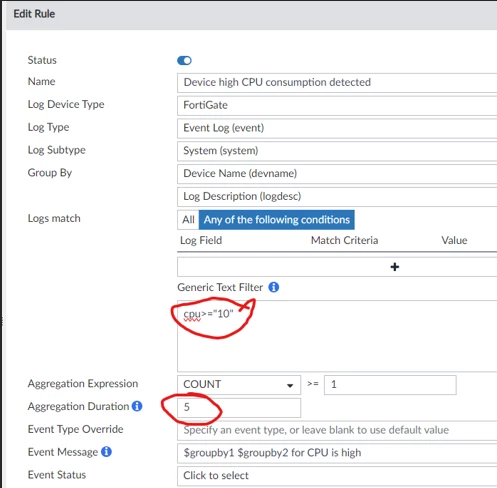

Edit the CPU consumption detection, set the duration of the handler and change the CPU threshold:

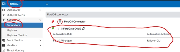

Step 2: create Playbook. Before creating a playbook, make sure the connector is updated with the webhook created on the FortiGate:
Once the automation rule is there in Connector, go to playbook and create new playbook:
