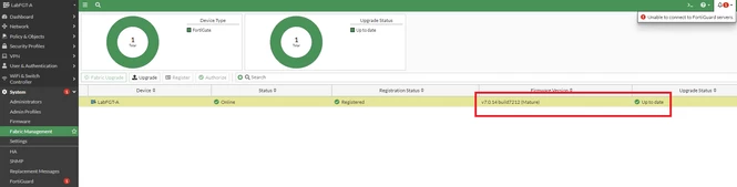

System -> Fabric Management -> Upgrade', shows ‘The firmware is up to date’ and Upgrade Status as 'Up to date' if the device is not able to retrieve Upgrade Path information from FortiGuard.
For example, a FortiGate running v7.0.14 may show its current firmware as up to date even if there is a later v7.0 release.

If a device shows a warning 'Unable to connect to FortiGuard Servers', follow the troubleshooting steps in the article Unable to connect to FortiGuard Servers to restore connectivity.
The most common causes of FortiGuard connectivity loss are DNS lookup or licensing issues. Once it is able to connect to FortiGuard, the device will automatically update the available firmware information.

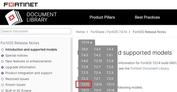

Available firmware versions in a Minor Version have Release Notes. It is also possible to subscribe to an RSS feed of Fortinet firmware releases, as shown in the article Subscribe to RSS feeds for alerts on new Fortinet firmware releases

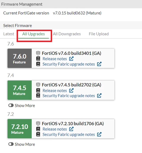

'Up to date' means up to date within the current Minor Version:
The firmware page will show the current firmware as up to date if there are no further Patch Versions in the branch, even if the End of Support date for the current Minor Version (e.g. v7.0, v7.2) has passed. If the device can retrieve upgrade path information from FortiGuard, other Minor Versions will show under the ‘All Upgrades’ page. The End of Support date for FortiOS v7.0 is 2025-09-30.
