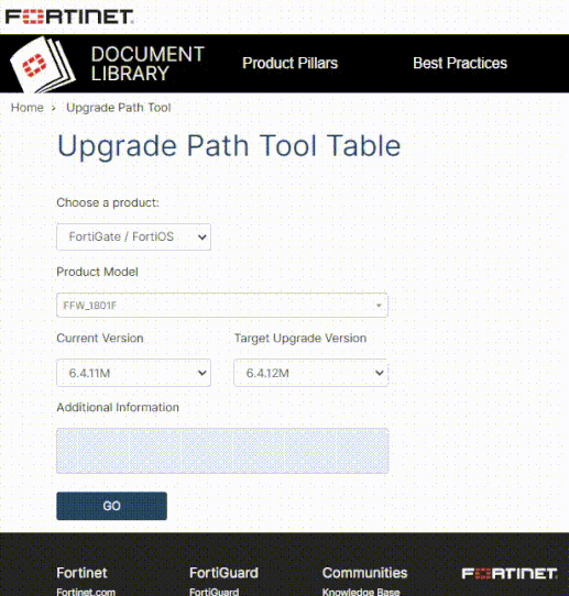

To check the upgrade path from a given start and end firmware version, refer to the Upgrade Path Tool Table. Note that the Upgrade Path Tool will only show information about ascending upgrades (minor version to major version).
To determine a downgrade path (upgrade path in reverse), set the 'Current Version' drop-down list to the target older firmware version, and in the 'Target Upgrade Version' drop-down list set the FortiGate's current FortiOS version. The list the is produced can be followed in reverse (i.e. downgrading from newer firmware to older) to reach the older firmware destination.
